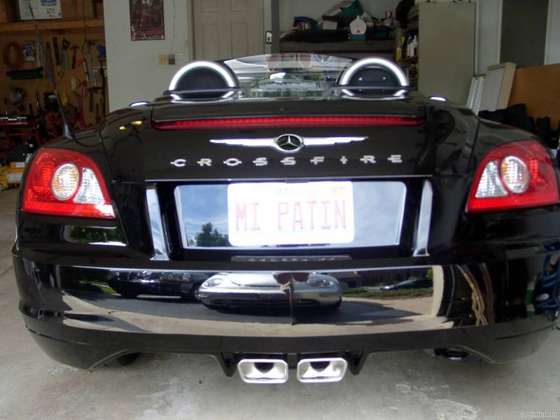

Old Aug 3, 2008 | 07:04 PM
Default Re: Rear Fascia Panels (Rear Diffusers) - Before & After
Pained mine black to match the car's paint.

what does MI Patin mean in english?
Old Aug 5, 2008 | 08:08 AM
velociabstract's Avatar
Posts: 4,525
Likes: 29
From: Puerto Rico
My skate. (I espeaka spanola)
