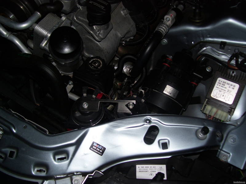

I also relocated the horns inside the engine bay using a stainless steel door plate.
