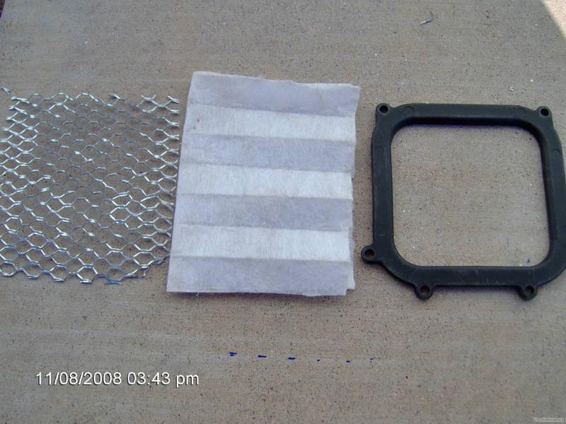

MATERIALS: (seen precut in photo two below)
Medium to fine metal mesh (medium flows better)

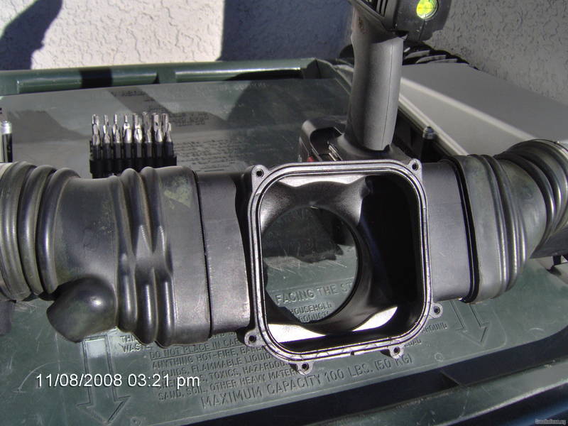

Gather materials, remove intake assembly and the back intake plate.
Using a hack saw cut the mounting "ring" away from the rest of the back plate. You will end up with just the outer mounting plate as shown on the right in photo below. Use the file to even and smooth things out from your rough saw cut.
Draw an outline of the outer part of the mounting plate onto the mesh.
Cut the mesh to match the mounting plate.
Cut the filter material large enough so you can double the material over for twice the filtering effect.

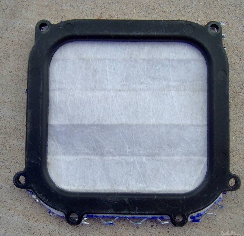

Stack the materials in this order- mesh- doubled filter-mounting plate.
Here is what you should have.
Using the original screws install your new performance intake onto the intake assembly.

Installed picture

Nice job, I was wondering when someone was going to figure out how simple it would be to make one of those lol. Did you use gutter guard from Lowes, that is what your mesh looks like.

You got the "simple" and the "Lowes" part right.
The mesh is actually left over stucco mesh from a stucco job.

Just one question. Would it not seal better to sandwich the mesh on top of the filter material, so as to have the filter in direct contact with the Y-pipe? May this create a more effective seal to keep out dust and debris? Or would that suck the filter into the lobes of our supercharger...

Might seal better but then you have nothing to keep the filter material from getting sucked into your supercharger $$$$$$$. That's the purpose of the mesh.
The mesh that I used actually has some thickness to it so I took a hammer and pounded it flat so that it would seal better. I also toyed with idea of doubling the mesh so that I could totally encase the filter material. But that meant more restriction and more thickness to the filter assembly.
I saw some 1/4 inch metal netting (Garden area) at Lowes that looks like it would work great for this application. Check it out.

Whats is the blue stuff in the pic? Some sort of glue?

Looks like marker
Special air lubricant. Allows the air to slip right through the filter.
Or it could be my blue marker, can't remember.
