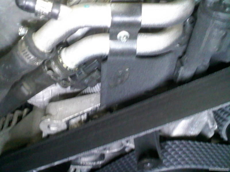

First off I'm not even sure I have the mid-pulley but it looks like it's about 68.3mm. Down low there are some great gains according to the but dyno. Punch it and be careful you don't snap your passengers kneck. I'm hitting 15#'s of boost almost instantly. Bad news is I was only peaking 16#'s. I'm thinking the new gator back belt might be slipping. I only had time for a few runs tonight. Maybe it needs to break in a little? I will try and do some more testing tomorrow and if I keep getting low boost I will probally ditch the gator back and try the stock belt. I also have a lot of wiring to do. I don't think I'm gonna make it to the track this sunday, but if I get everything sorted out I will be competing at Import Face Off next weekend.

Wow, with 178mm crank and 68,3mm SC you are bigger than 185mm now...
Are you leaking boost somewhere? Normally you should be over 20PSI with this Pulley-Configuration. Good luck!

I bet you are having belt slip. The only time I ever had a boost leak was from a worm clamp on the y pipe slipping off. That is about the only place large enough to bleed off that much boost.

Yeah, if my measurements are correct the supercharger would be spinning about 500rpms faster than the 185 at 6k. I need to get ahold of brandon an find out what size the pulley is supposed to be.

Iam hitting 20 at the manifold with my 178 on the street. You need to look for the air loss, something is going on there, good luck W

Boost leak was my first thought. I replaced the intake manifolds last week and put the needswings catch can on and was getting what I thought was a vacuum leak. Hooked the computer up and got no codes and was hitting a full 18.5#s. Needswings said it was probally the catch can or manifolds echoing.
When I saw 16#'s peak last night I too though boost leak, but I haven't done anything to create one, so since I put a new belt and smaller pulley and only hitting 16#'s I'm thinking belt slip. I'm gonna put a few more miles on it today and see what happens. My friend told me the mustang guys have had problems with the Gatorback belts and to see if I can find a Gates belt. I might just pull the belt wrap kit off and go back to the stock belt.

update:
It's definetly belt slip and probally my fault.
Either the belt jumped or I am just an idiot and lined it up on groove off So I just took it for a quick spin. OMG! It feels awsome and pulls so hard and it's almost 80 degrees outside right now. I will hook the computer up later and get some boost readings. AF looks good so far. I'll have to keep an eye on that belt since it burned quite a bit off.

Glad ... no, not glad ... relieved to hear it's installer error and not a real problem. If you can borrow a dial caliper lots of people would like to know the true size of the new pulley.
(I love photos, thanks for taking them)

Just found out I am missing one of the three Idler pulleys that come with the belt wrap kit. So my flub and this missing pulley are a good reason for the belt slip. It's pulling like a beast right now as it sits. More testing tonight. Stay tuned.
HEY SRT WHEN I E-MAILED BRENDON AFTER I RECEIVED MY MIDSIZE PULLEY AND WRAP KIT I ASKED ABOUT MISSING SHIMS AND 3 RD MISSING PULLEY FOR WRAP KIT, HE E-MAILED ME AND SAID YOU DON'T NEED SHIMS WITH THE NEW PULLEYS. WITH THE MIDSIZE & 178MM CRANK SETUP YOU USE THE 2 PULLEY WRAP KIT. ILLCYA

Ok I C. You are right. Only two pulleys for belt wrap kit for me. DOH! I guess it was all my fault.

Hit 20#'s tonight in 70 degree weather, intake temps were around 150 on the first pass but peaked 170 after a few multiple pulls. Bad news is I am still getting a lot of belt dust build up so it's still slipping or rubbing somewhere. I am pulling the belt wrap kit off tomorrow and putting the stock belt back on to see what happens. The gator back belt is pretty ate up now anyway. I was told by several people to get a Gates belt so I might try to find one.
