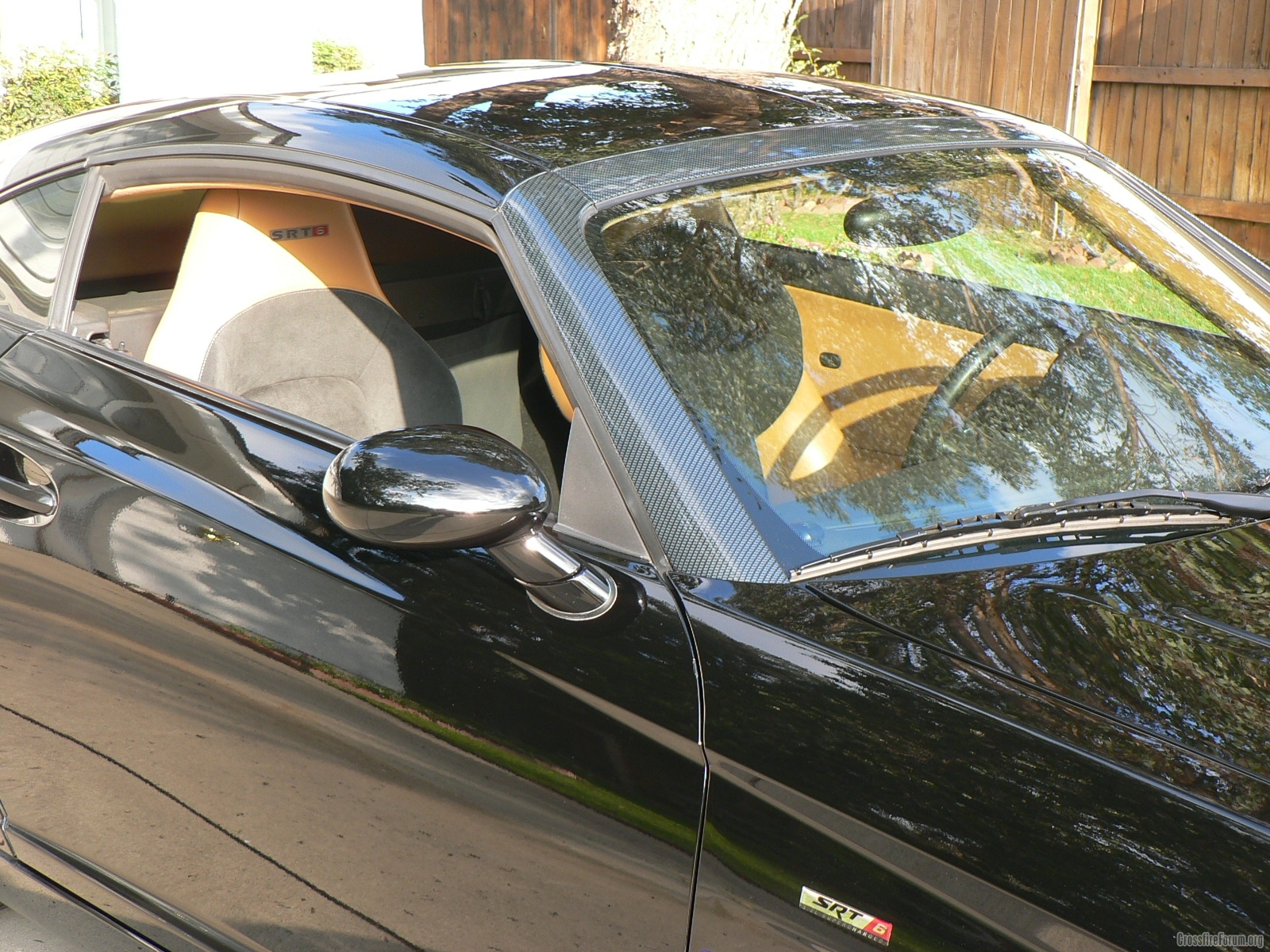

I did the hydrographics CF overlay on my windshiled over 2 years ago and still love it. I did the standard grille with it as well and liked it until I went with the black PC mesh.
You could do the hydrographics overlay on just about everything including the plastic with a CF or even the black chrome. It can get a bit pricey. Powder coating is definitely out on the plastic.
I had a tint on my lights but the subtle curves made it very hard to get rid of all the bubbles. Even with them gone there were "orange peel" patches. Funny thing is one headlight and one taillight came out about 90% perfect while the other two were noticeable from about 10 ft. I finally decided to go with a spray tint and added HIDs. Look is awesome and very clean.
That looks real nice! Where can I get the CF overlay from? I think that would look sharp on my car.

Do a Google on hydrographics. My guy does it for .60 cents per sq "
You should find someone local. When done properly, it is at least as good as the paint on our cars. You can go with any color CF, brushed or wood grains. Take care of it like the paint.
