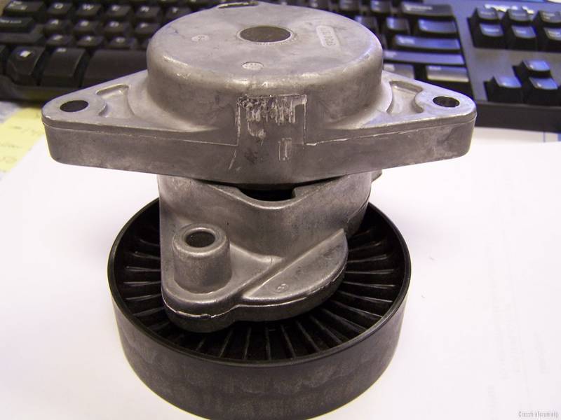

Here is the spare I purchased

that is the tensioner... the idler is the small one up next to the S/C pulley, or in my case, down above the alt. pulley.

SORRY YOU DID SAY IDLER MY BAD
I didn't get a extra idler I guess I should.
