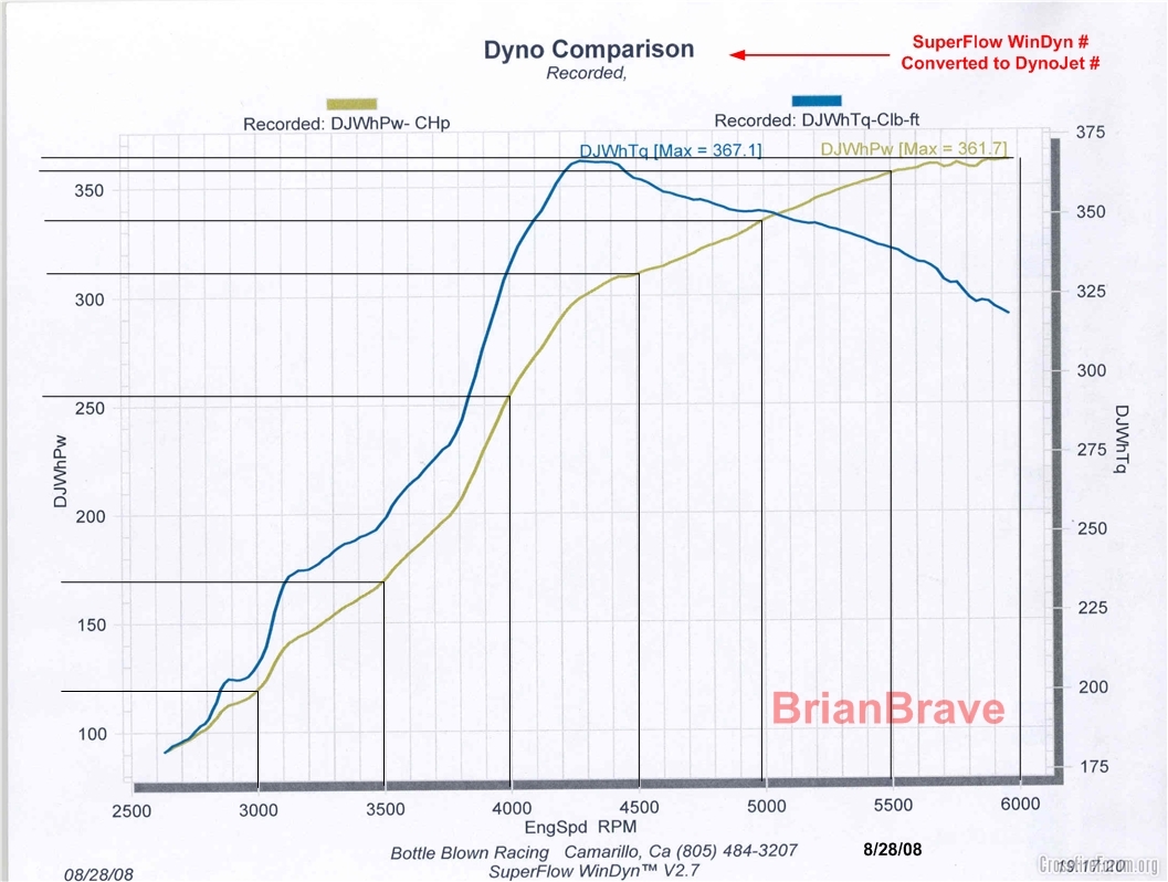

Made 362 rWHP With those mods.... And what a monster!!!

Sweet graphs. 4300rpm looks like a nice place to be.
