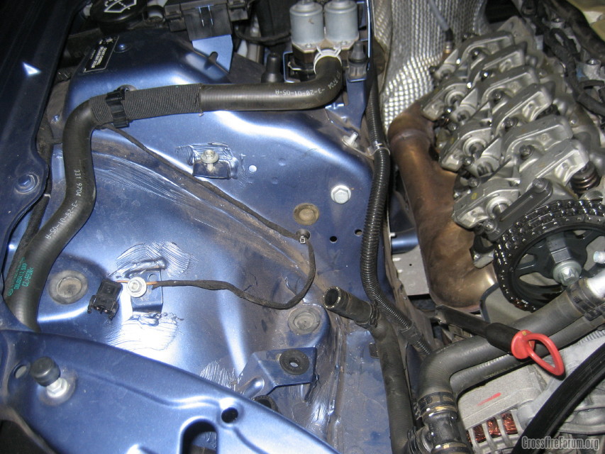

<--- Huge Horsepower
Posts: 3,217
From: So Cal
Default Re: Water Coolant Resevoir
A Thousand Words.....

That was an old pic Doc... he put his shiney custom IC tank in there and polished up all his engine parts..... your memory is going man.....
