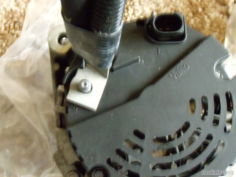

MikeR's Avatar
Posts: 5,180
From: North Plains, OR
Default Re: Need Help... Alternator Nightmare
Softball, here is the pics of the MB Valeo alternator....and the battery cable setting in place....
It looks like you got the wrong altenator....

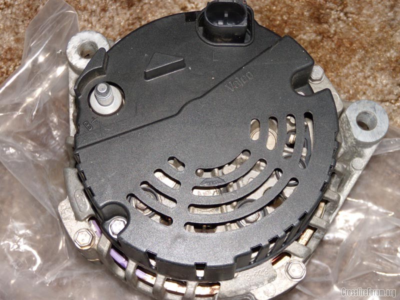

Posts: 383
Im thinking this alternator would be the correct one. Its off a members limited, but i'm sure it will work for the SRT 6 since mine is a Valeo as well.
Thoughts? Mike and Z?
Well, that one will fit and hook up fine.... as I mentioned before, I dont know if there is a rating difference between a NA and SRT... can't think of why there would be, but.......
