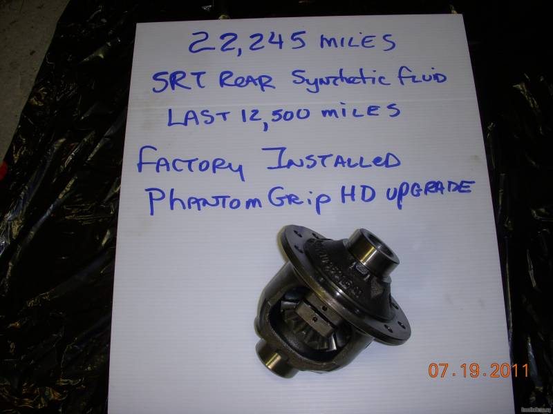

FOund a photo of the bolt sizes for thoes that do their own, may save you some time. Also picture of my rear.
Loading the photos has not been working again, aaarrrggh!
Check my Pain in the rear gallery. Woody
