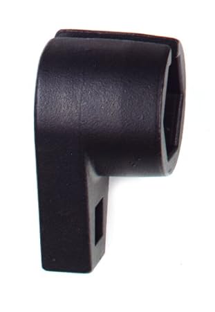

Don't forget this:
Powerbuilt 648691 Oxygen Sensor Offset Puller
Powerbuilt 648691 Oxygen Sensor Offset Puller : Amazon.com : Automotive Powerbuilt 648691 Oxygen Sensor Offset Puller : Amazon.com : Automotive
Old Nov 28, 2013 | 12:09 AM
Mr. Max's Avatar
Posts: 916
From: Pasadena California
Default Re: Need some help from the "Mod" Squad. (Tech. guys)
Thank you my friend you saved me some time and hassle. I'll order one now.

Don't forget this:
or a 22mm wrench
