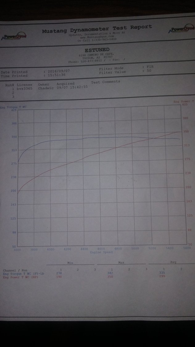

I'm getting a dyno tune Wednesday and will post the data. I've read some comments about AFRs with my current set up being a potential problem. Some say with a dyno tune it is manageable and others are more in line with your comment. I will know more after the tune. Right now without the tune the car is really performing as compared to stock intake and pulley but I need data to see where I'm at. My 62mm pulley is EC but is not aluminum. It is an upgraded steel product they just started producing a few months ago. I don't have a saver kit and the stock belt was adequate. EC said they've sold 70 of them with no scattering or complaints with no slippage.. I'm in Tucson, AZ. We are about 1000ft above sea level. Its humid now so in November I will take it in for a retune. My dyno guy says he can manage the AFRs and I will see more torque gains than HP although he's done SRT6 crossfires before with similar mods and got good gains in HP. I will know more Wednesday and let you know how it comes out. As far as the DCAI not enough gains to justify the money. Port and polish the heads and hone the valve guides and there will be more than enough air moving.

You guys are all far more experienced in these cars than me, but these are my numbers on a mustang dyno, on average 12% less than Dynojet. 350hp and 342lbs of torque at 5800rpm. 12.2 AFRs. Only mods are the single NW cold air intake and a 62mm EC supercharger pulley. No tune and crappy plugs I changed out today. Dyno results do matter and I haven't seen any support even a moderate increase in either hp or torque on this forum. But I defer to your experience with the DCAI. I'm good with the single. Thanks for the reply Doc!

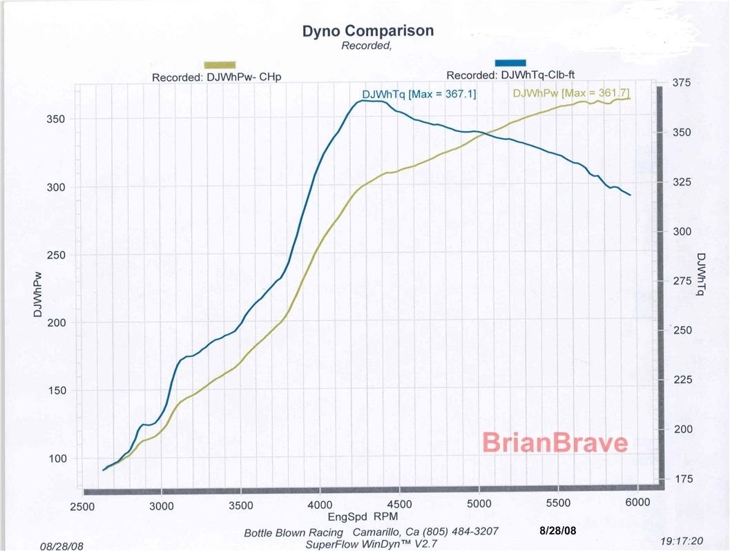

Here's my dyno result from way back - - with the mods in my signature.
Only items to fail me so far have been the headliner and the interior door pull.
Do the maintenance and these are damn fine cars.

Those are awesome numbers! Great job. I might get there with a tune. I only have the single CAI and 62mm pulley but pulled in fourth gear 350hp and 342 torque at 5800rpm. In a third gear pull I had 410lbs of torque. This was on a mustang dynonameter. They tend to be lower than a dyno jet by around 12%. I also had washed out spark plugs. Replaced them yesterday. I had to do my headliner too.
Thanks for the post. Good stuff!

BB - You've stuck with the 74mm Stock Pulley? - just checking as there isn't any in your sign..
~19psi (sea level) ?
Any record of g/s air at red line from the ECU?
Yes, Stock S/C pulley. I did replace the smaller idler pulley that came with the crank pulley kit with the OEM idler and installed a larger serpentine belt to compensate.
7 years and 70K miles later, I still run the same setup with no issues.
With this setup, I max out at 21 PSI at sea level @ 80F
