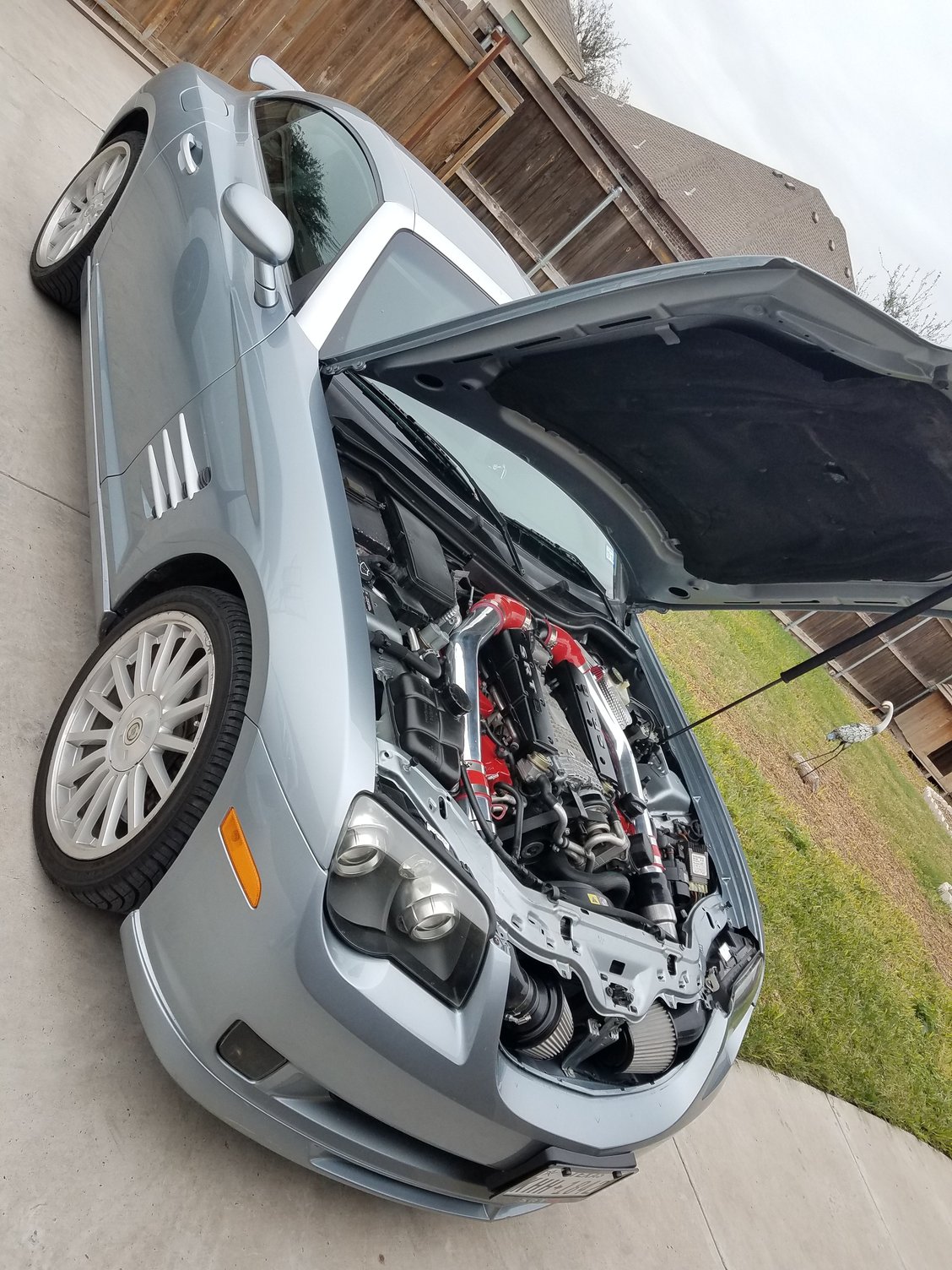

Hi guys, let me first introduce myself, I'm Axel from Pharr, TX. I just bought a SRT-6 about three months ago. It is a well-maintained, totally stock and with 112K miles on it.

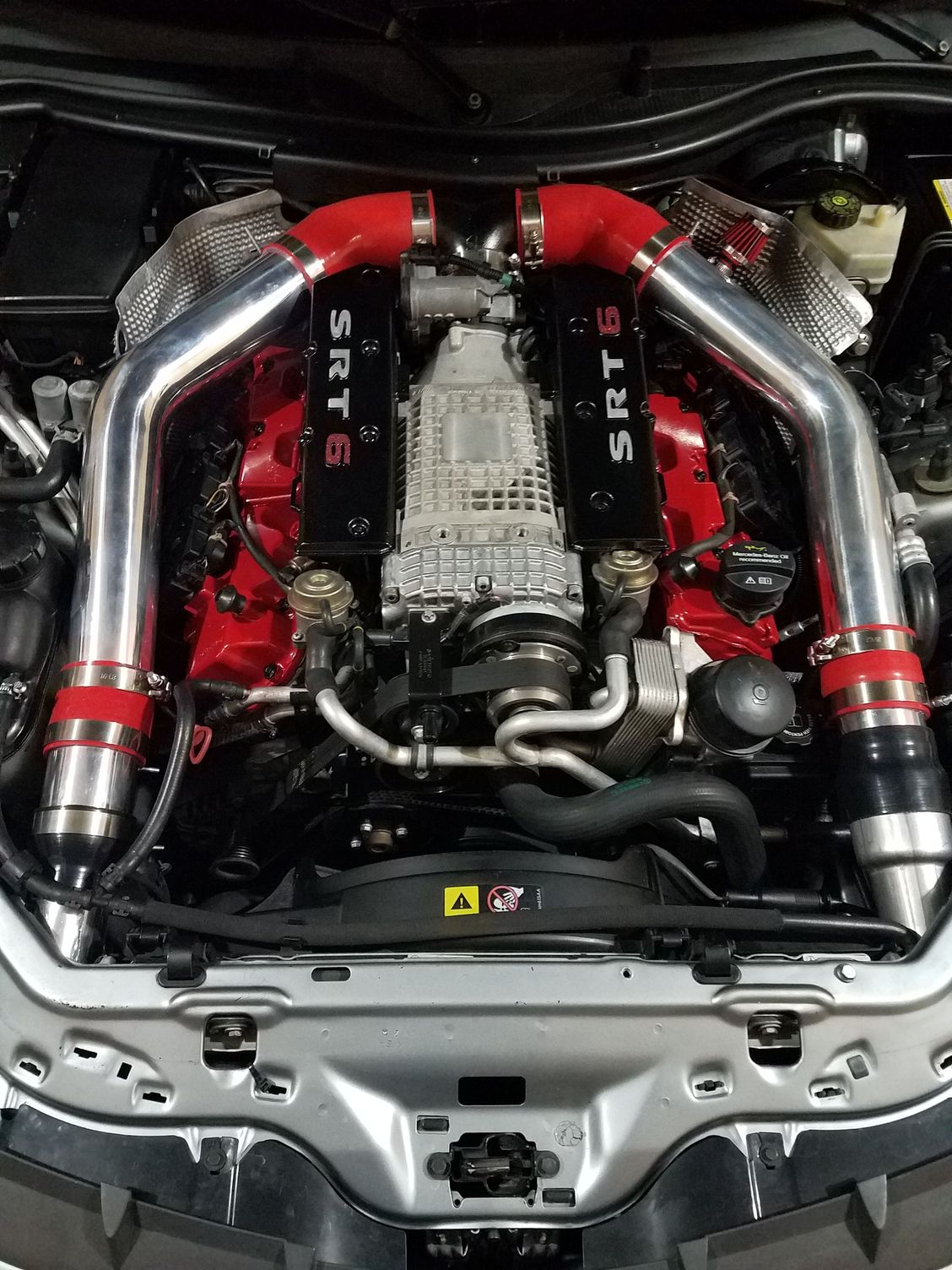

I always loved sport cars specifically the Crossfire. So, the story is that after being driving it for the past months and I recognized the potential of the engine, I started looking good for aftermarket parts in order to make it faster. However, as you guys know, the parts for our cars are really price. So, first, I decided to go custom with a DCAI and here is the result. This is just the beginning! Let me know if you guys like it.

Nice job, but I wouldn't call that Killer Chiller exactly stock
Since it looks so nice, a few suggestions to finish off the job :
1. get some sign edging for the heat shields :
Amazon Amazon
2. Get some nut caps for the wiper arms : http://www.needswings.com/wiper-arm-nut-caps
3. polish up those front air pipes
4. get an oil catch can : http://www.needswings.com/needswings...n-kit-r170r193
5. get a pulley guard : https://www.crossfireforum.org/forum...er-pulley.html
6. get the driver's side wiper arm grommet : http://www.needswings.com/wiper-arm-grommet

Is your y pipe rubber or metal I used a e55 y pipe flexible

My Y pipe is actually custom made of aluminum. I went to a local machine shop and they were able to cut on half two 90 degree aluminum elbows and then welded them together. That's how my Y pipe was made.

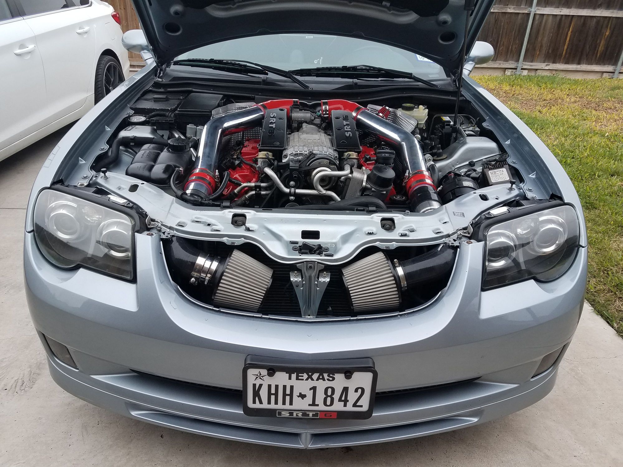

Congrats on the new ride it looks to be well maintained. The DCAI installation is very clean and well thought out. I just love to see a clean and detailed engine bay.
