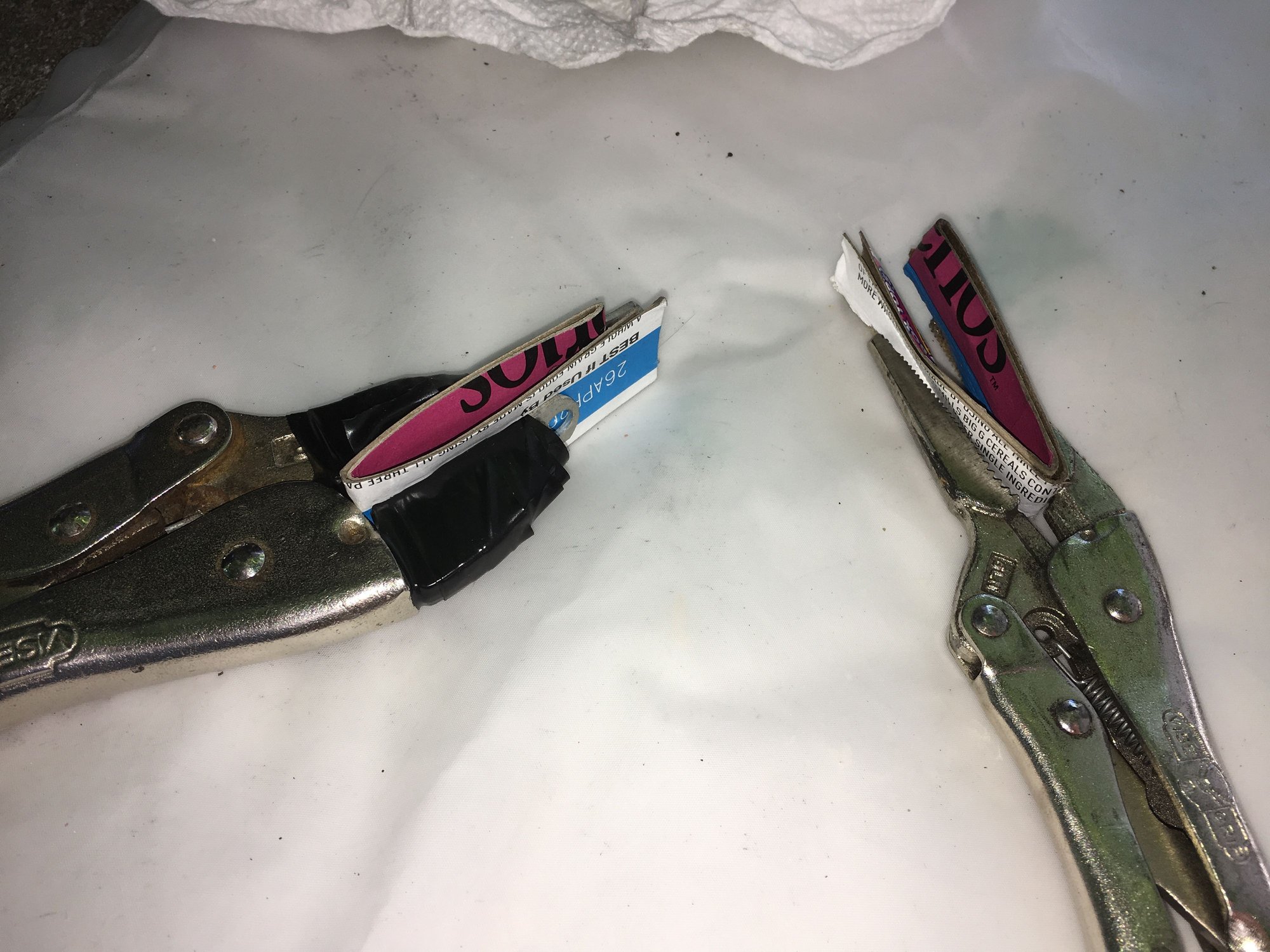

Additionally I have read where some have used c-clamps or vise grips with something soft in the jaws to clamp the hoses off to keep fluid in while doing the change. I plan on trying that and will report how it goes. EDIT, this method works fine.
Ready to install the new pump
cardboard covered vice grips
only lost this much fluid

The pump is very easy to change, just completed the work and road test. All OK so far.
