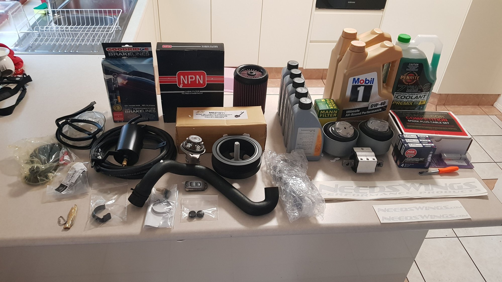

Box of goodies arrived today from NeedsWings!
Pulled in to the local Autobarn store to get Oil and coolant.
Came out 10 minutes later and found that I had made a new friend.Parked beside me was this beautiful Sapphire Silver SRT-6.
I waited an extra 10 minutes eagerly to see the driver and was not disappointed.
Lovely middle aged lady by the name of Vivian came out of the Chemist next door and we had a quick but good chat about the cars and their rarity.
Hopefully I will be organising to get the parts fitted in the coming week or so.
