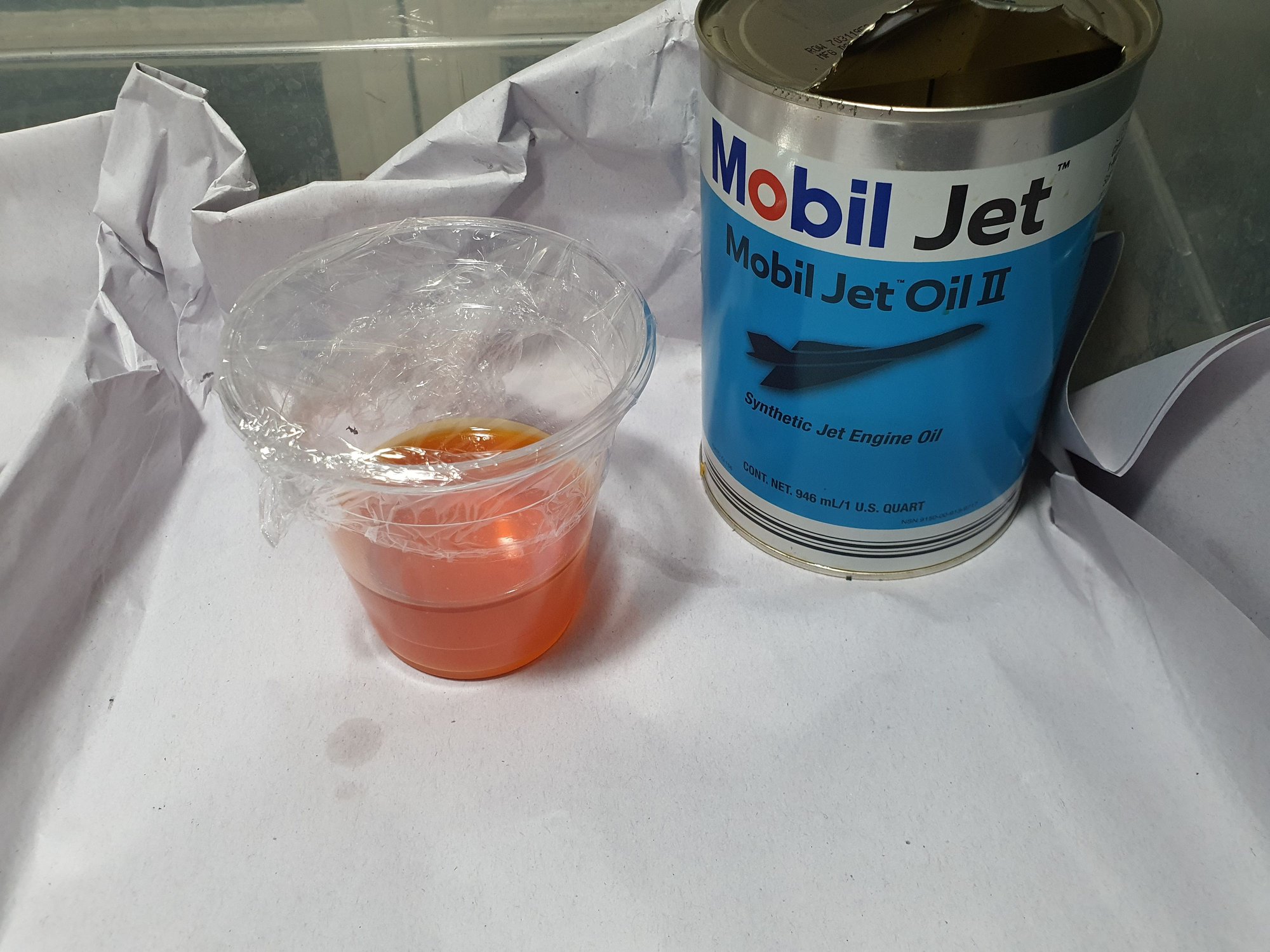

Hello,
I did interesting test with ACdelco supercharger oil and Mobil jet oil.
I know ACdelco supercharger oil is same with Benz OEM oil.
Anyway I will not use jet oil to supercharger.
ACdelco supercharger oil VS Mobil jet oil
After 5-days later...
The cup filled with jet oil was melted.
I think it can break oil sealing mechanism of supercharger.
Below is my personal opinion.
"The amount of Jet oil of airplane is checked before and after flight by mechanic. Supercharger is not jet engine.
Jet oil can be used at supercharger, but after long time use with heat, it may break oil sealing system of IHI supercharger as it melted plastic on my test.
So the amount of oil should be checked as mechanics of airplane do."
I have used jet oil for 7-years and 40,000 miles(Total 120,000 miles) and found oil leak in this year.
I changed all bearings and seals, but still leaks.
If I can buy supercharger which has no leak, will not use jet oil.

My point is that as Mobil jet oil melts plastic, it will affect rubber seal or break any tightness with longtime use.
Is here someone who expain why jet oil melts thin plastic cup?? Normal engine oil will not.

Some plastics are broken down by some liquids, while another plastic remains unaffected.
If the seal material was damaged by Jet Oil another seal material would be used.
You an buy seals made from different materials that are least affected by the liquid it comes into contact with.
Seal catalogs give ratings for various seal materials and liquids they could come into contact with.
Acetone dissolves ABS, styrene and Polycarbonate among others but does not affect polypropylene.
A thin layer of acetone on two pieces of ABS or Polycarbonate will allow the pieces to be joined together.
The acetone liquifies the plastic allowing the joint to hold together when the acetone evaporates.

180, Thank you very much.
You are an encyclopedia!!!
Then, mobil jet oil contains some ingredient dissolving a materials which is not compatible with.
In Applications of mobil jet oil, it says
"Mobil Jet Oil 254 is completely compatible with all metals used in gas turbine construction, as well as with F Rubber (Viton A), H Rubber (Buna N), and other commonly used seal materials.
(All of the builder approvals are aircraft engine builders) Clearly this product is for aviation use only (Turbine engines)"
I think "other commonly used seal material" is restricted to Turbine engines.

Thanks copperfieldkid.
The reason why I have enthusiasm with Jet oil is "Oil leak in my supercharger"
Not just scatter a little but sprayed a lot as below pic.
Also I found oil outside seal when I pulled out SC clutch.
Then I found it melts plastic cup so I suspected jet oil may melt rubber seal during long time use.
May the reason of leak is not caused by jet oil but in my experience and circumstances I have to doubt jet oil.
It's my personal opinion and I have no objection jet oil is good for turbine engine.
From now I will stop jet oil issue.^^ Thaks a lot.

Your problem is a failed seal, it has nothing to do with the oil.
Change all the seals while you have the SC apart.
