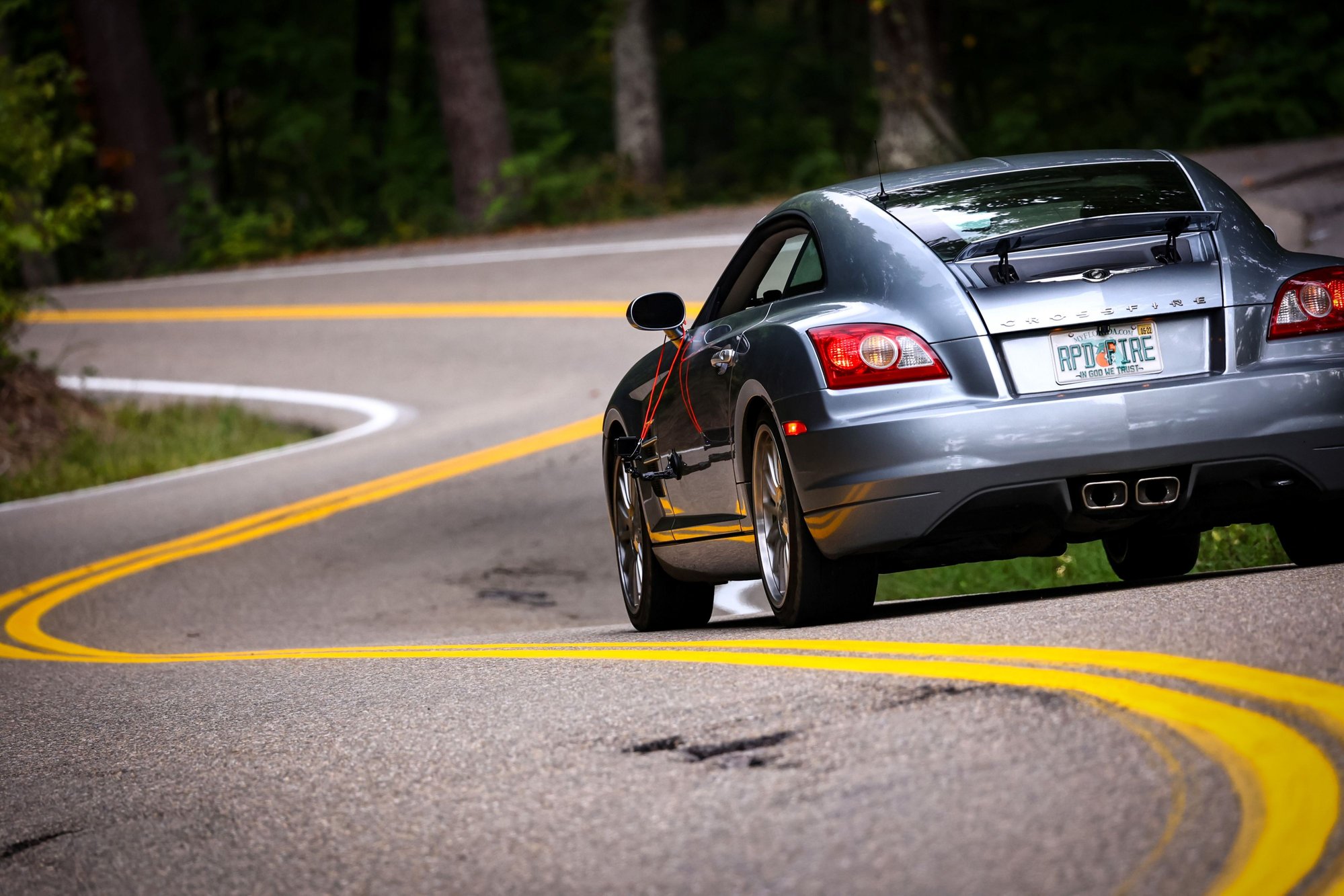

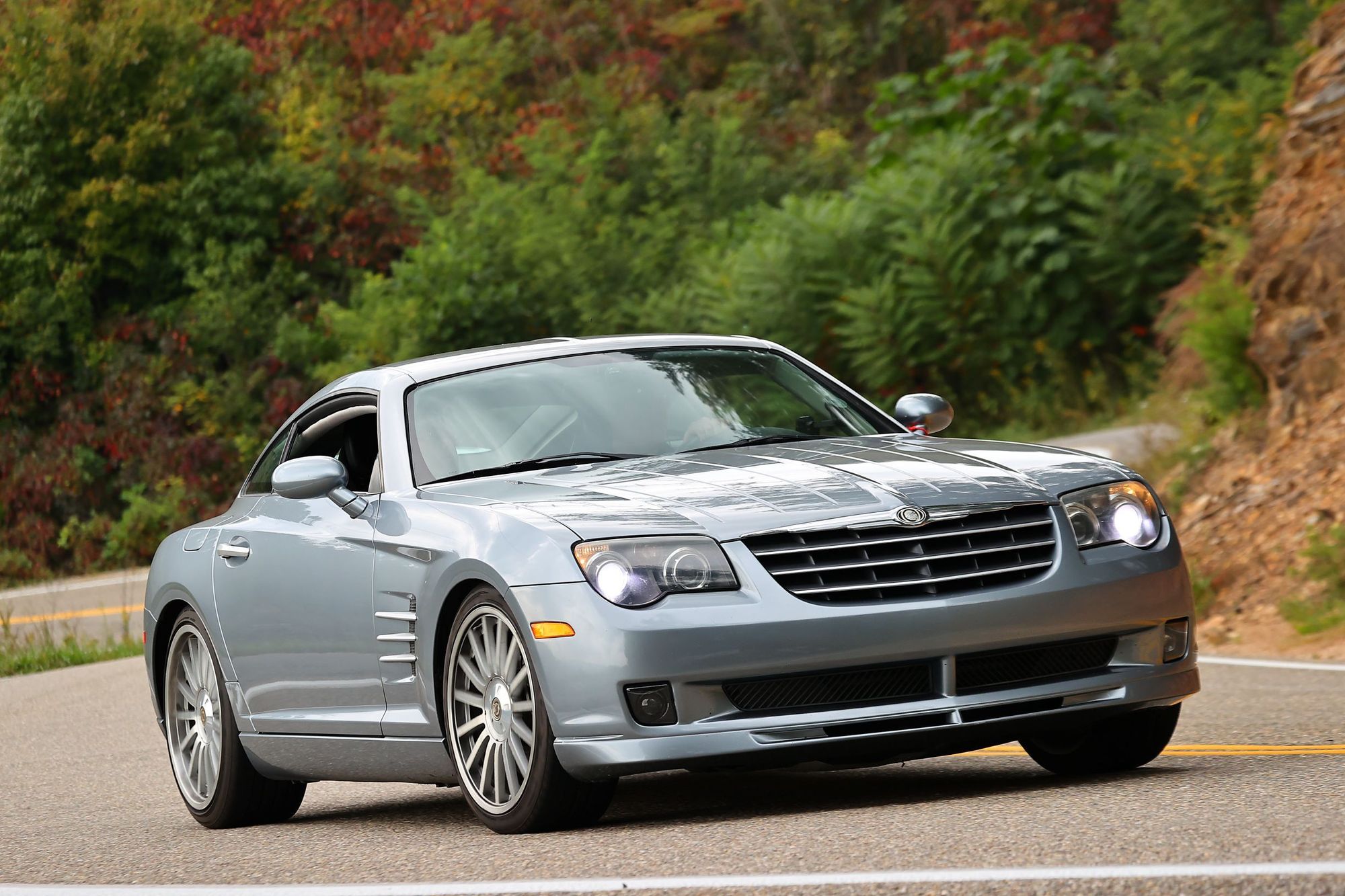

I received some pics back from the picture vendors at Tail of the Dragon, and I just had to share. Here's the car last weekend at the Dragon, with my 17 year old at the wheel!
