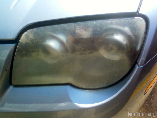

I think I officially had the roughest looking headlights on the forum.

So I bought a $9 Turtle wax kit.
This is the final result, the other steps can be seen in my gallery
Old Jul 4, 2010 | 03:15 PM
ChuckNorris's Avatar
Posts: 716
Default Re: Turtle Wax Headlight Polish Kit Review
There is still a few light marks on the lenses but not bad overall. On the second headlight I used 800 grit wet dry sandpaper as the first step and reduced the sanding time with pad 1 ten fold. Great kit and great price.
