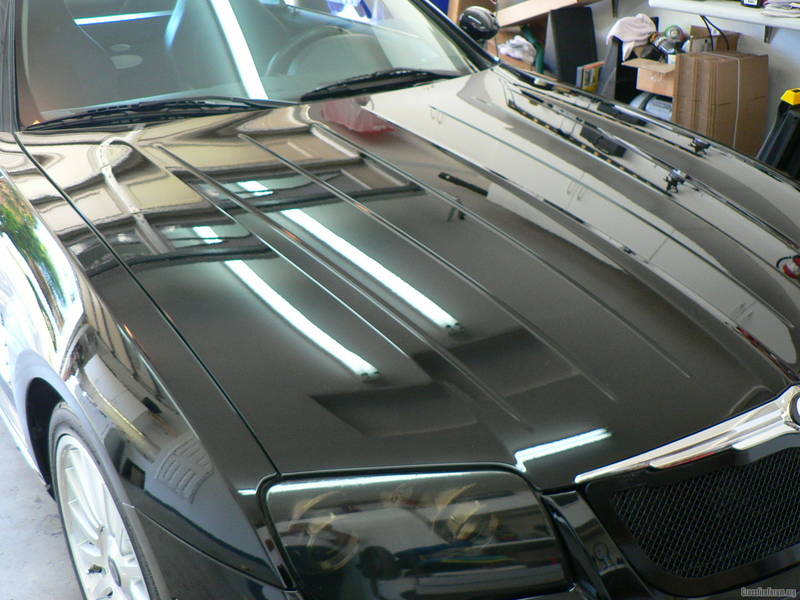

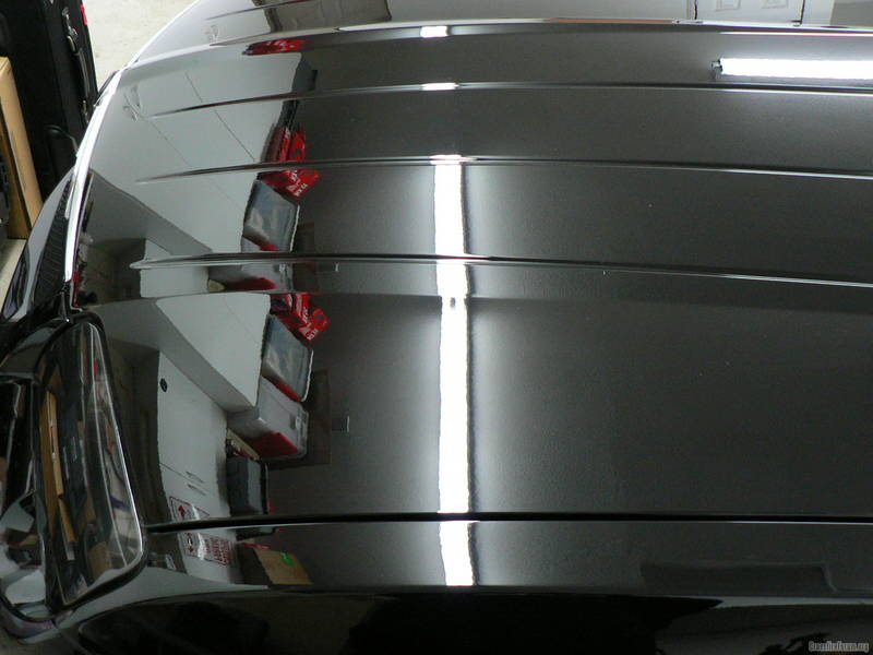

bmorgan gave you some good info. NOTHING looks better than a swirl and scratch free black finish. Did you know mirrors have black backings?
One of our resident finish experts Mike-in-Orange (he runs the blog for MaGuire's) has some good comments here https://www.crossfireforum.org/forum...tml#post462126
It will take time and lots of effort, but you can have a black beauty too!

I forgot how well black can look when well taken care of. Hats off to both of you for a fine finish job.

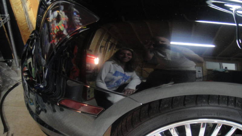

I use Turtle Wax Black Box Wax. No white residue. Results;

SRT SIX - Enough is enough! Your car is far too shiny! Shiny to the point it looks like a rolling garage wall and ceiling! I think you need to get out the sandpaper and rough up that finish a bit
by the way that shine is A M A Z I N G!

Insomnia made me do it...LOL

damn that looks good! where did you get the turtle wax for black? ive been keeping mine in the garage for the last couple of months, but im about to move soon so its back out to the elements it goes,

Props man! Gorgeous!
But to add something a little constructive, I have always heard that over waxing a car is not a good thing either. It can add a haze effect to the finish, max about two times a year. Is this not correct? I typically use a quick detailer in between waxes, not a full wax job. I have found that it keeps the shine, and keeps the surface of the car slick. Also plus one on Meguair's Products, I typically use Meguair's NXT Wax, and I have never had an issue.
With all this said I have never really owned a black car, just darker colors....so I don't know how much this helps.

I think over-waxing causing a haze is probably something of the past. With the new synthetic "waxes" lay up nicely. Sometimes I lay a nice thin coat once a week, but probably more likely 1 1/2 to 2 times a month. It only takes 10 min. I probably use a clay bar 6 times a year as well.
I also use only a little each time. I also use Meguiar's Ultimate Quick Detailer on a daily basis. I don't think you can see any haze on my finish...
I have only washed it 4 times in 5+ years owning it. Keeping it looking this way is a "career" job. My wife calls it an obsession, after a stressful day of work, I call it therapy!
Like I said in an earlier post, "NOTHING looks better than a swirl and scratch free black finish."
