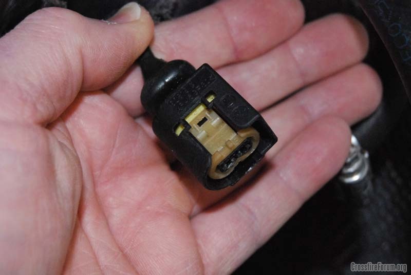

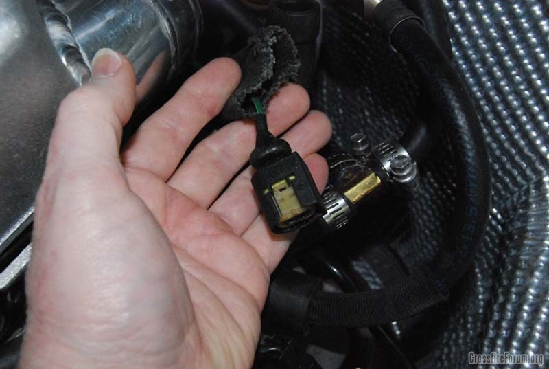

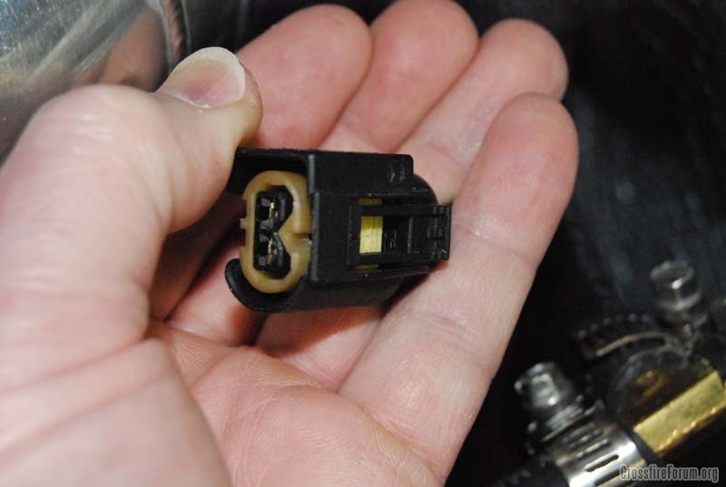

here is what the CPS connector looks like....
