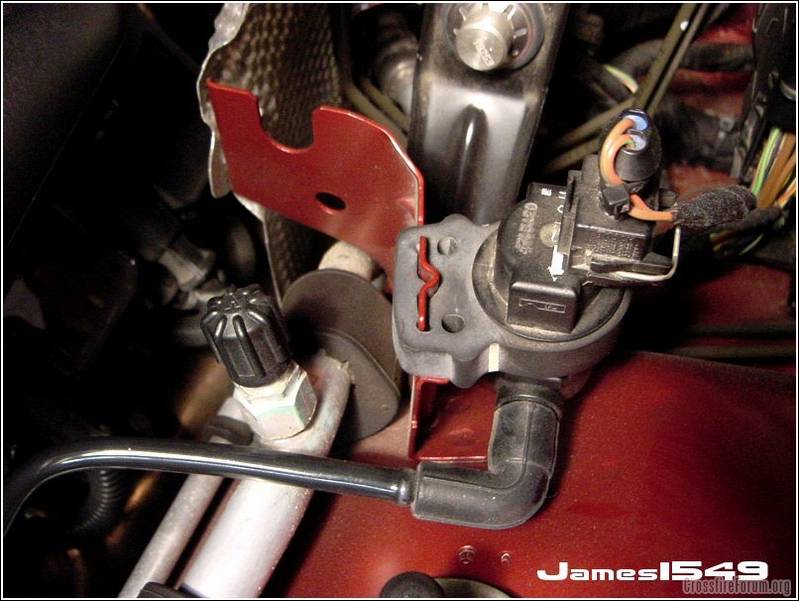

And you are absolutely sure it is not this solenoid clicking, it sits on the left side of the eng on the fender well. I thought I had a lifter noise until I put my hand on this. As the eng warms up, the clicking gets quieter and then stops once warmed up.

James,
I took my stethescope over and listened and it is coming from the drivers side lifters. Loudest on the center cylinder location. Passenger side is very quiet.
