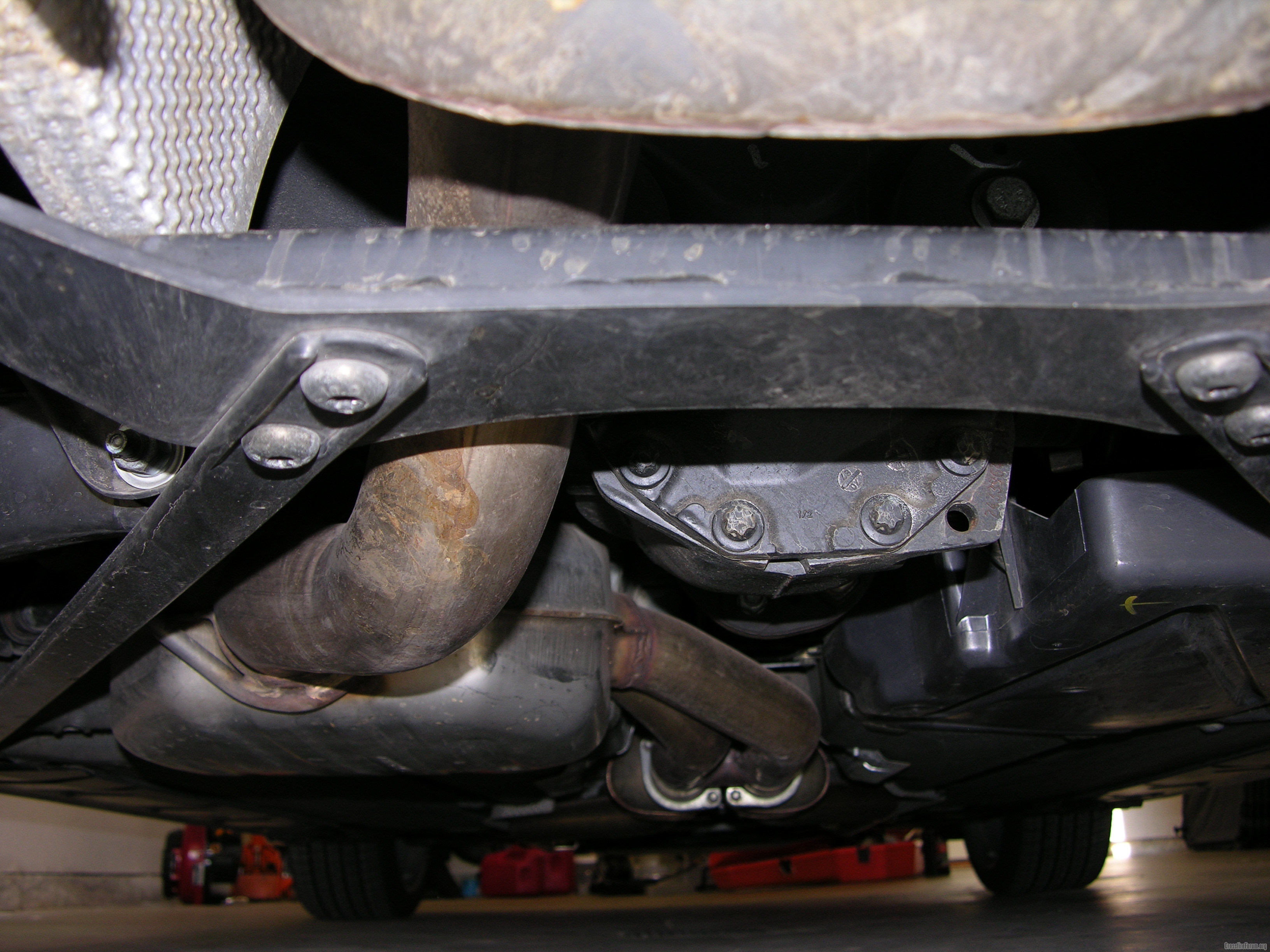

Did you happen to test fit on a roadster to take into account the rear bracing?
No we didn't, but I'm almost positive the stock exhaust is the same for the roadster and coupe. This exhaust takes up less space then the SRT exhaust and is routed the same, so it should fit.

Correct, the stock systems for coupe and roadster are the same.
Here is a pic of my bracing if it is of any help.
