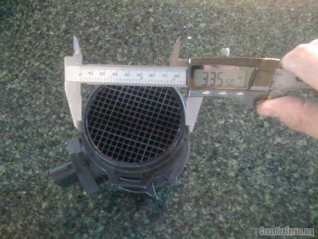

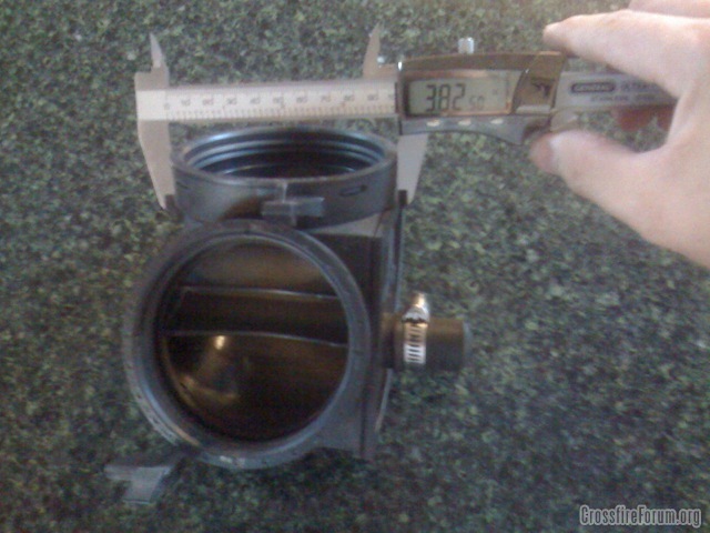

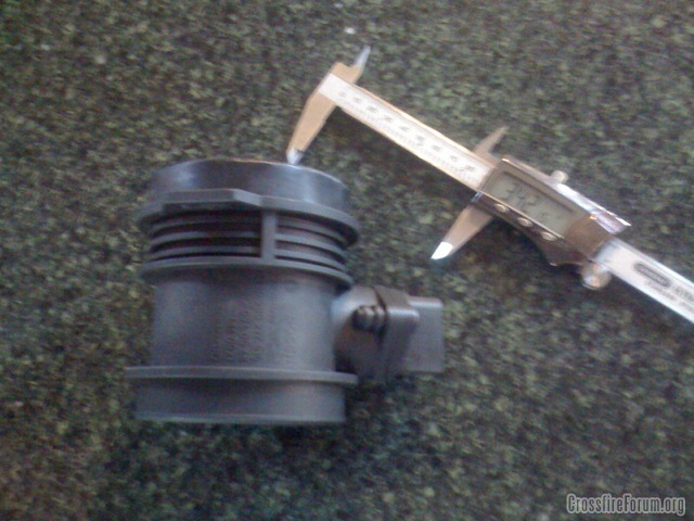

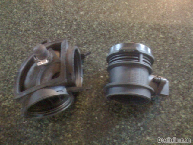

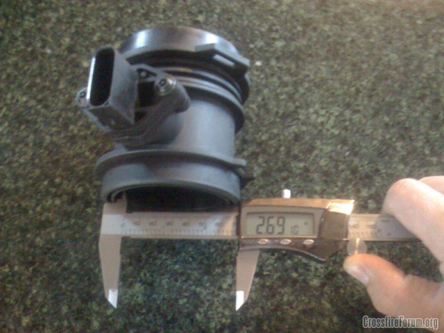

Since I'm at a stopping point until about Wednesday, I figured I would post up some pics of the MAF. It is a pretty stocky unit and I love the honeycomb grill before the sensor. This is something that is highly sought after to smooth airflow in other applications! It also looks like the I.D. of the maf is only 2.69". Still, I am running an even smaller restrictor in the rotrex to keep boost under control so it is still larger then what I need

I also forgot to note the blocked off port on the TB tube. That is where I have my pcv blocked at the TB. Don't want to put 13 - 15 psi in the crank case!!!!!!!!
