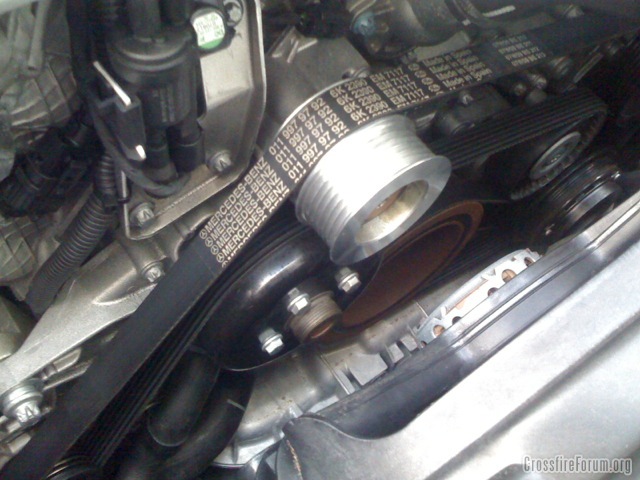

Well, things are coming together albeit slowly. Little by little I am making some progress despite the set backs of getting sick then hurting my back. That said, I look for things to start picking up over the next week or so. For now, I do have a pic to share.
This is my newly designed idler pulley and mounting bolt. I hope to have it in my hands by the end of the week and installed on the car this weekend. I then want to put some miles on it. It should be more than rock solid!
