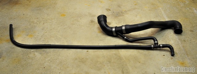

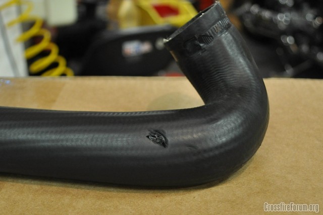

Back up and good to go !!!!
Thanks to rcompart (Rudy) I got the replacement upper radiator hose assembly today.
MB part# 170-501-25-82......$45.48
He used his contacts and got it to me overnight to my door.

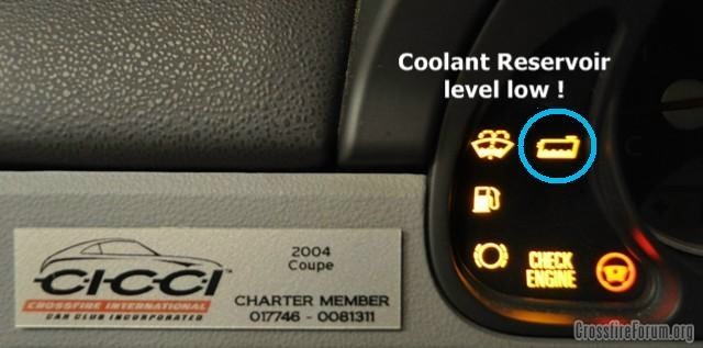

Here are a few pics of the old worn through hose and the hose assembly as well as the coolant I used to refill the system.
Worn spot on the upper radiator hose
Upper radiator hose complete assembly
Low Coolant indicator
Zerex G-05 premix 50/50 ready to use formula - $8.79 per gallon - Napa Auto Parts

I had checked to find the same wear mark on my car. I dont run pressure in the coolant system and have less to worry about as a result.
I took a file and beveled down the posts shown in the photo so that they could no longer interfere with the hose. The little sharp edge of the plastic post really does a nice job of cutting the hose covering.
I have the factory hose clamp in correct position so I suggest that you all look at your cars before the trip this week to carlisle in the heat. It can happen to you too.

Since nothing mounts there.... just grind, or file, them off.... problem solved......
Old Jul 3, 2010 | 11:19 PM
Posts: 18,105
Likes: 1,598
Default Re: Upper Radiator hose ALERT
Certainly can't hurt but if ya just twist the hose slightly outward from the fan shroud at the radiator neck and then tighten the clamp there is plenty of clearance as well.

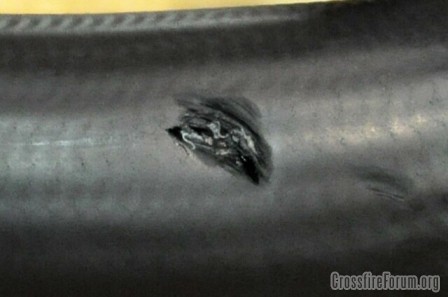

Old Aug 11, 2010 | 10:29 AM
Posts: 8,488
Likes: 853
I have a 04 Coupe with 57000 miles on it.
Well today I was lucky.
I was close to home when I discovered a pin hole leak in my upper radiator hose. I lost some coolant but not much and did not overheat.
I made it home and found that there is only one upper hose in the US and it is being shipped to me.
The hole was caused by constant contact/rubbing on the plastic cooling fan shroud in a spot where there are two round raised surfaces with sharp edges.
I have attached a few pics to show you where to look to see if your hose is rubbing this spot or not.
Looking for feedback from all of you with your findings.
This is a view on the drivers side of the engine compartment in front of the power steering pump.
Gary:
While performing some underhood maintenance & detailing this morning, I took the opportunity to look at the upper radiator hose on my 2007 Coupe. Turns out there is about an inch of clearance on my XFire on the radiator bosses you showed rubbing on your 2004 model. The upper hose on my 2007 makes nearly a full 180 after the connection and completely avoids this intereference. Looked like Chrysler became aware of this issue sometime later and changed the configuration of the upper cooling system hose to eliminate the issue. Or the hose on my 07 was installed differently at the factory and oriented so that this interference doesn't occur.

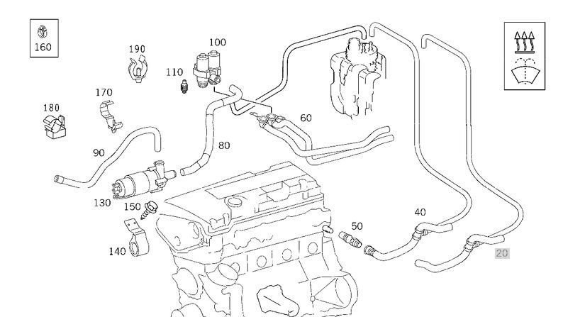

looking for part # 5098632AA for 06 coupe - Mopar site indicates no longer available.
Old Dec 26, 2025 | 07:34 PM
  #39 (permalink)
NeedsWings's Avatar
Posts: 2,761
Likes: 194
From: Michigan
is it in this diagram? disregard the engine block shape
