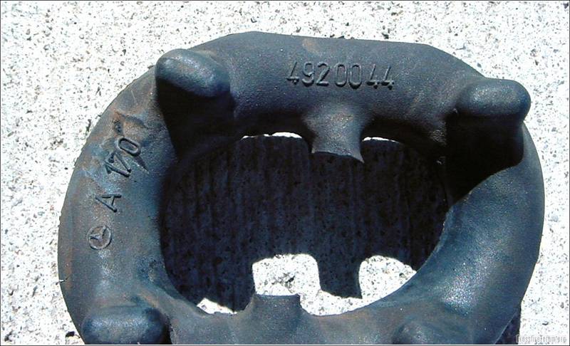

You should be able to purchase them from any muffler shop. All you need are the rubber bands. If you have no luck, try calling MB with the following part number:

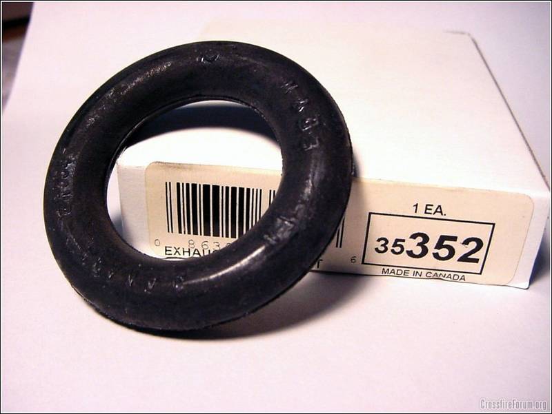

These are on my car right now, from NAPA:
