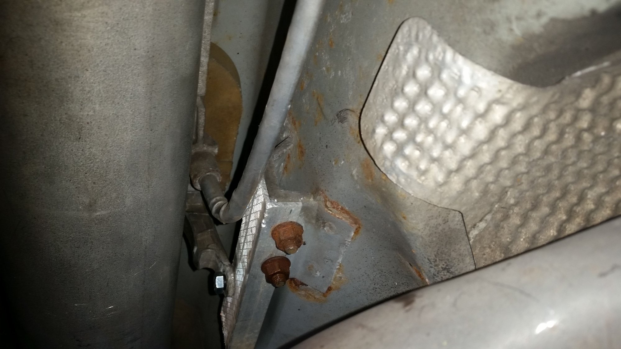

Front off of transmission
New shifter bracket on drivers side, bushing on bolt and the cast aluminum bracket for movement, cut part of the cast aluminum.
And with the aluminum bracket i made
Passengers side shifter bracket.
Bith sides are made from aluminum angle, passe passengers side didn't need to be as long as i have it..

Cut off the bracket on passenger side for the carrier bearing, and coated the bare steel so will not rust.
and cut the back driveshaft safety bracket for extra clearance. That was in for the 2 piece driveshaft, if the carrier bearing broke, the driveshaft would not hit the ground.
would not be hard to put in a safety loop.
