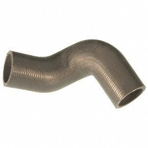

Just wanted to share some info with the group. I recently have been working on the cooling system(new electric fan and water pump). While removing the upper radiator hose which is part of the complicated multi-piece and multiple connection hose, the hose ripped where it meets the thermostat housing. The whole assembly is around $90+ on eBay but I only needed one part of the assembly and didn't want to mess with removing the whole thing anyway.I got lucky and found a replacement hose and thought I would share the info.
At auto zone the part number was 14-2159-0 (~$12)and it fit without trimming even though it is about 1" longer.
Here are the cross reference part numbers Google gave me.
GATES 21735
CARQUEST 21735
RoadMAX C1735
GOODYEAR 61458
MOTORCRAFT KM-1684
MOTORCRAFT KM-1699
Hope this saves someone else a little headache.

Thanks for that info.
A dollar saved is a dollar earned.
This part only applies to the NA.
Shown is the Gates part.
