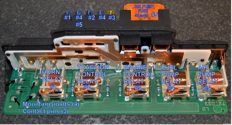

Possibly the fuel pump relay. If yer handy open the RCM and check to see if the fuel relay is closing on startup.
If not, close it manually and see if she runs.
Here's a picture that some old dude posted before to help ya out.
Old Feb 23, 2017 | 10:11 AM
Likes: 650
Default Re: Need Help!! Stranded
That is an old photo, it has been updated.
