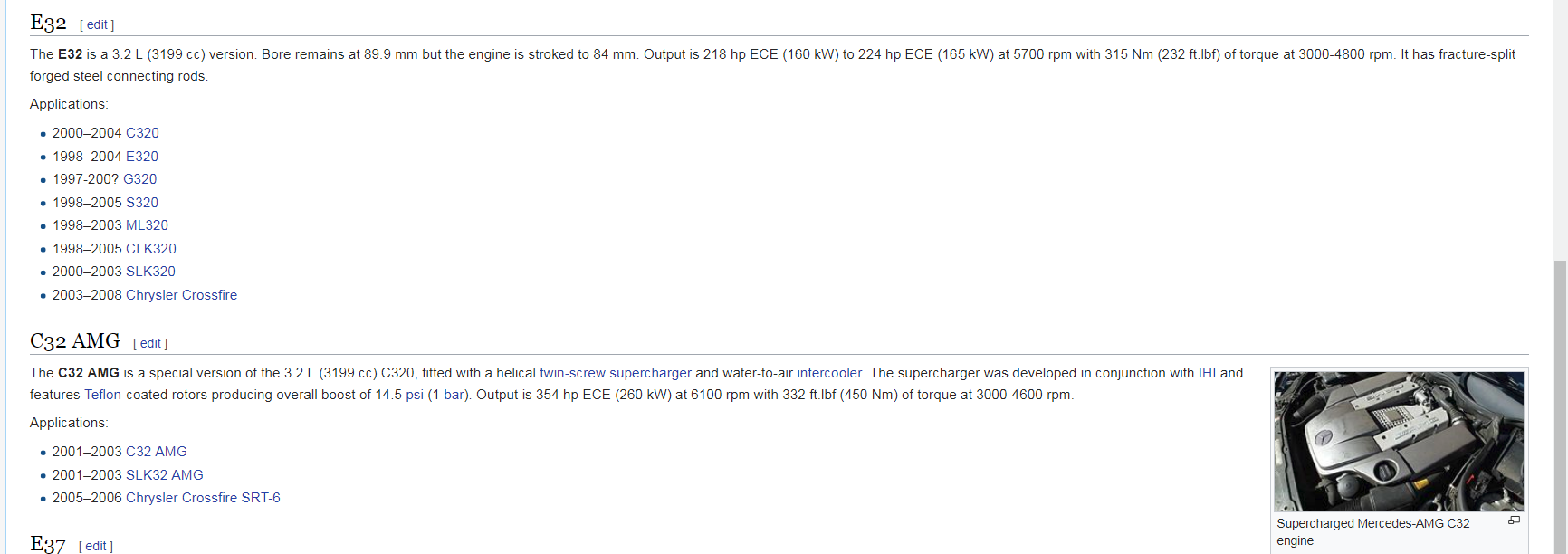

What Mercedes models and years share the NA Crossfire engine?
Old Jun 26, 2018 | 05:24 PM
Default Re: Crossfire NA engine
I'd say any that have 320 in the model number
