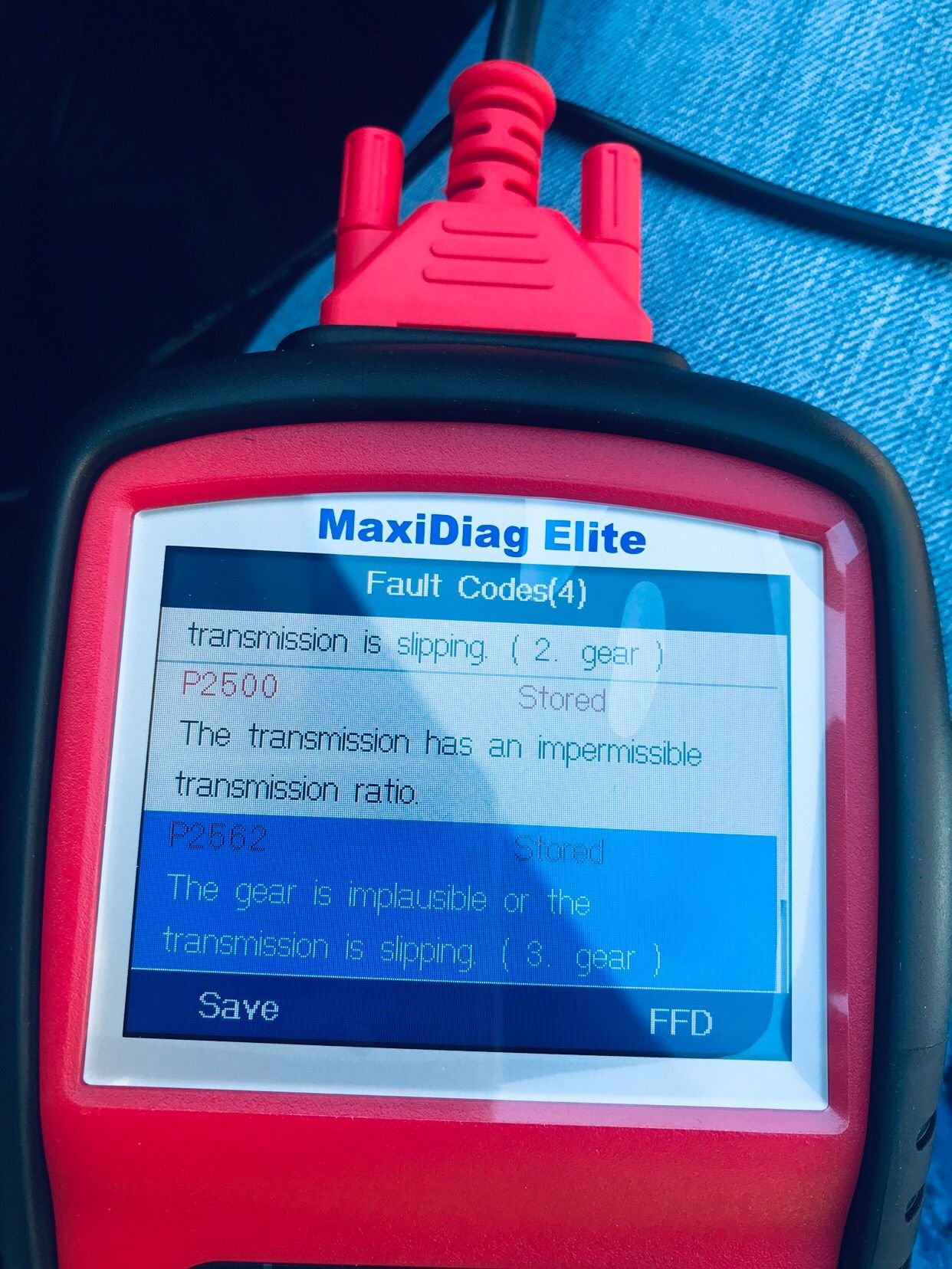

Got the following codes. Any ideas what the solution might be.
I’m thinking of swapping out the conductor plate and go from there.
Any suggestions welcome.

Speed sensor problem.

Replacing the conductor plate that carries the speed sensors your error code shows is the main repair, the sensors themselves can be replaced but needs special tools and soldering. Replacing the 13pin connector at the same time is recommended.
