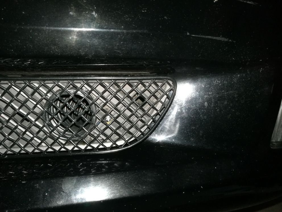

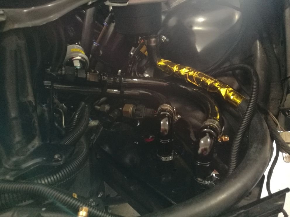

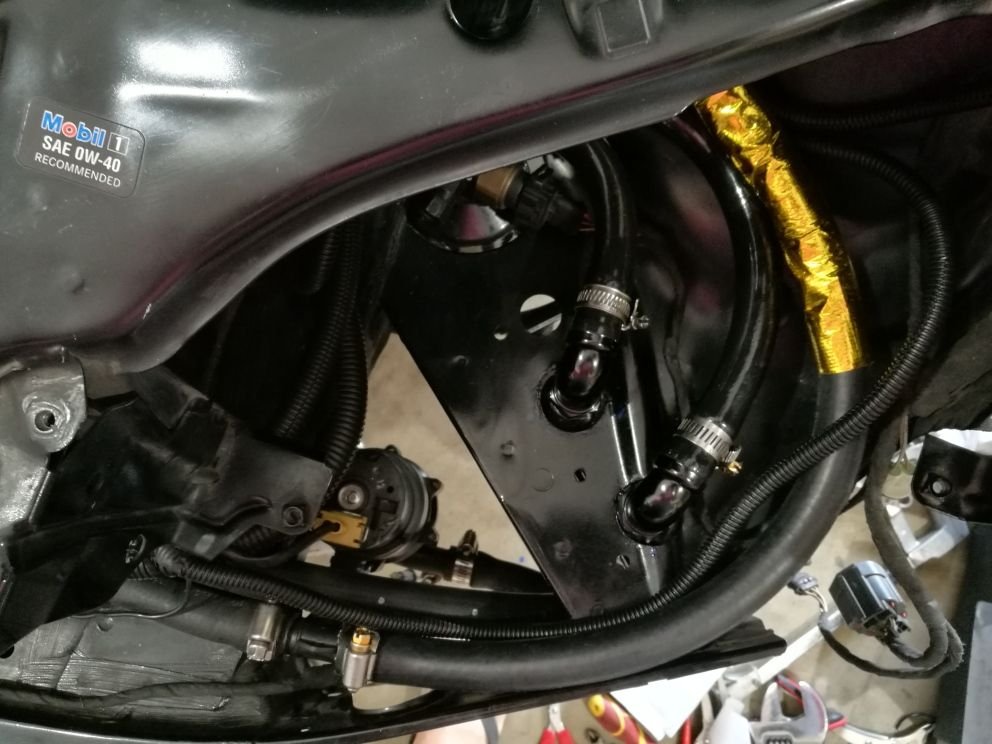

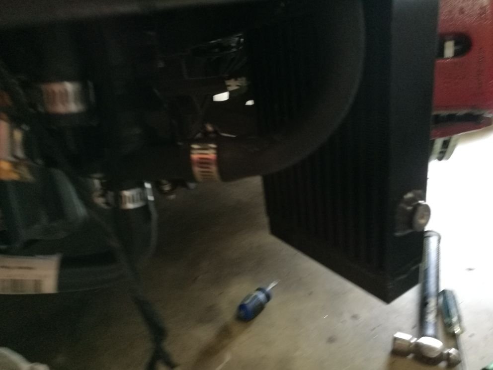

Hi,
I fitted some 10AN oil cooler adapter fittings https://www.vrpspeed.com/product/ofaf/ to the engine then ran hoses to a small Mishimoto style oil cooler https://www.ebay.com.au/itm/Universa...frcectupt=true. I mounted the oil cooler in the space in front of the LHS front wheel, directly below the headlight. I removed the headlight and drilled two holes straight down to allow the connectors to the cooler to protrude through so I could connect the hoses with short 90deg AN fittings. The cooler was supported from below with a couple of 90 deg brackets (it just fits). I don't think you'll need a fan as the oil doesn't get very hot. I routed an air duct to the front of the cooler and replaced the plastic access hatch in the wheel well with some steel mesh. The hoses also provide a good opportunity to mount an oil pressure sensor. Here's some photos. Let me know if you need any help with your conversion.
Space for Oil Cooler
Oil Cooler in Place
Hoses to Oil Cooler (including oil pressure sender unit)
Hoses to Oil Cooler (from top, directly below headlight)
Air duct to Oil Cooler
Plastic Access Door Replaced with Mesh
