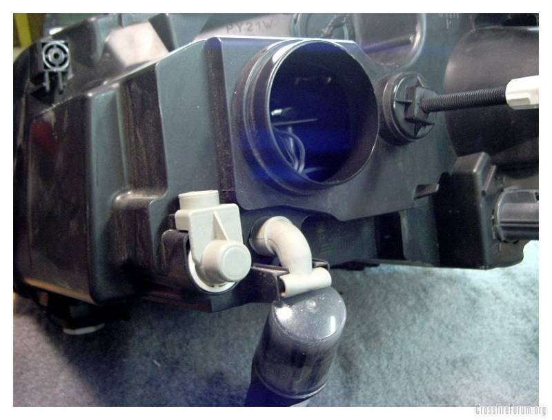

I only know of vertical adjustment for our headlights. It is controlled by turning a long, white plastic **** protruding from the back of the headlight housing. Read through this Sticky:
https://www.crossfireforum.org/forum...tructions.html
it will apply to HID's as well as halogen bulbs. Are yours way off? If so, you may not have properly seated the bulb in its little socket-it is a PITA.

There is a horizontal adjustment on our lights. Just a bit tougher to get to. One for low beam and one for high beam on each light.
I have better pics, just didn't have time to do a total search of my gallery.

James, under the white 90 degree cap?
Old Jul 26, 2012 | 09:23 AM
Default Re: Questions re: Headlight aiming/adjustment
Yea, but those caps are a biatch to get out ......
