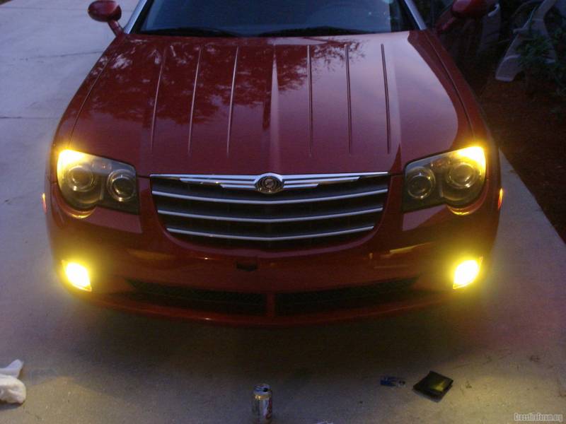

Well I got them in and I'm VERY happy with them. @ night they give off a bluish tint as well, kinda like the moonlight. ONLY prob is now my Check Light Indicator is on. No big woop, I'll prolly pull the led that lights it up. I didnt come on when I installed the HiD's so it must have something to do with the voltage going to the new LED's. Anyways here's some pics, lemme know what you all think!

Looks really cool but the indicator light is a concern.

Why? It's just telling you the voltage off... no big deal.
By the way they look great!

Methinks you'll have to install resistors in parallel with th eLED's to make it look like regular bulbs. The Indicator detects low or no current draw so LED's look like an open circuit.
