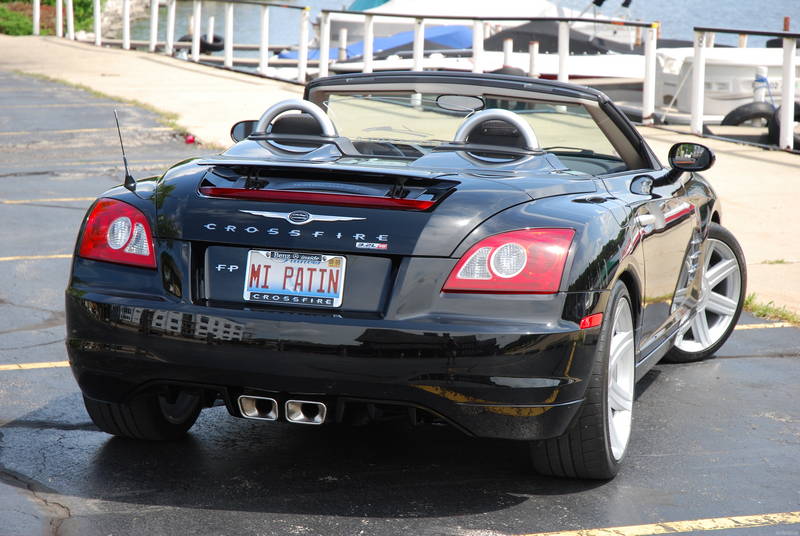

No yolk here anymore....
Fronts too?
Old Jul 29, 2009 | 08:38 AM
Default Re: Chrome Turn signeal Bulbs not working
Fronts too?
Yep, fronts too. No yolk....
