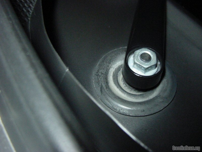

Both of mine are missing, not worried about it really.
But I did just help another member install a new siren. I didn't see any difference in the right and left caps when I removed them. Going back on, I put a nice glob of black silicone on each one to keep them from coming off in the future.

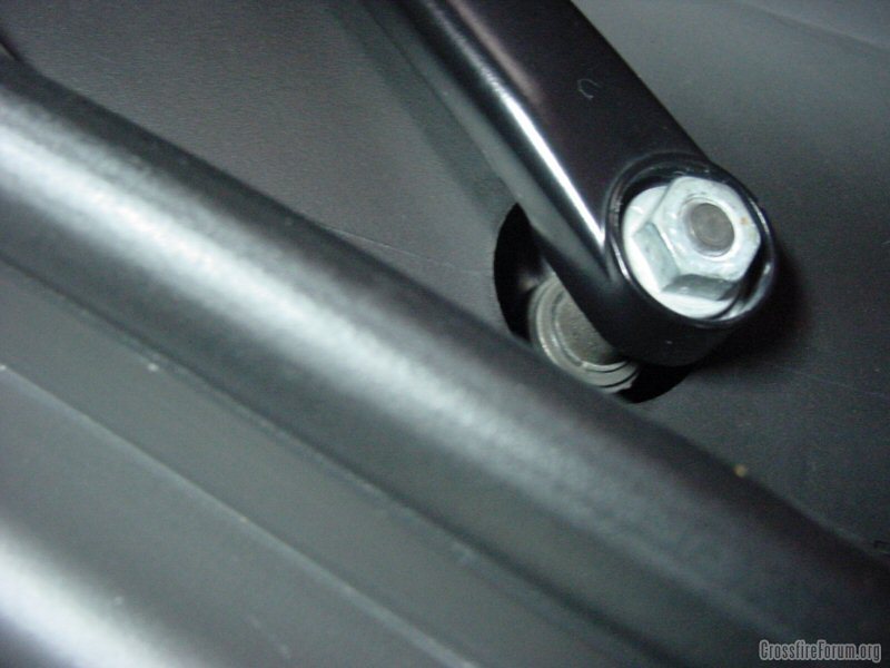

OK, I went out and took a look with a flashlight. Here is what I found:
LEFT
RIGHT

My driver side grommet is missing as well, as the wiper pivot is off center to the hole I think they left them off.
I had to purchase a nut cover as well, it was $7. but worth it.
