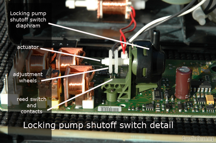

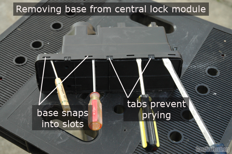

This is the central locking module. It had water damage to external electrical connecters and an internal problem with corrosion on some contacts.
Almost hidden by the frame rail is a silver shape that is the alarm control module. This one had corroded connections and a broken wire from the wiring harness, but no interior damage.
After removing the wiring connectors this needs to be removed:
this is next:
And here are the goodies inside.
The pump motor would not shut off properly and I found the contacts to be dirty. They are a bit hard to see behind the green plastic bracket.

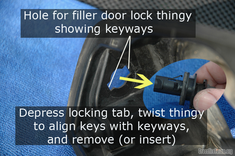

The gas filler bowl gasket was not sealing and water would leak into the fender area:
To remove the assembly you must diconnect the actuator from inside the fender cavity. The plunger and mating point has a locking tab that you can see by my thumb. It slides apart easily when you do it right. I was wedged in the trunk with my hands out of view when I removed it, so I didn't actually see what happened.
After the plunger is removed you must remove the latch thing. It is another task you must do by feel rather than sight. The picture shows it already out of the car. You must do it from inside the trunk.
Here's another view to clairify what you can't see:
The filler assembly is held in place by 4 tabs. I wish I had a picture for you, but I don't. The tabs are accessed from inside the fender area (naturally), and you will have to find them by feel. There are two on top and two on bottom, and you can depress them with a hard edge like the blade of a flat screw driver. They are a real pain to get to. Also, get a helper on the outside to pull on the assembly as you work your way around the tabs so they do not snap back into place before you get all four done. The door hinge extends behind the fender and makes the removal more difficult. Protect the fender with something or you will scuff the paint as the filler door grinds against it. I used a large refrigerator magnet, but you could use a few layers of tape, too.
A bead of black silicone does the trick. Just reinstall the filler housing and wipe away the excess.

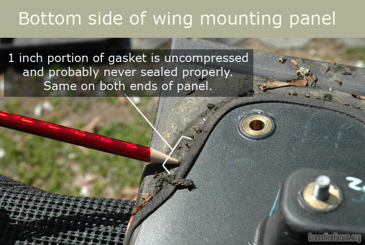

The leak that filled the trunk wells with water was found under the SRT wing mounting panel. A foam gasket was out of place and allowed water to flow into the trunk. It was completely undetectable, as the interior panels hid the flow as well as its source. Your only indication of a leak may be a bit of wetness under the trunk floor panel.
And another view:
A less significant leak was around the wing stud o-rings:
A bead of silicone was used around the panel and around the studs to seal out water. I hope I never have to remove those parts, as they will be firmly stuck in place.

3 weeks ago i noticed that my rear carpet was a bit damp after a large rain storm we had. Sure enough that weekend i pulled the spoiler off, and you can see where the gasket was barely touching. Plus the factory foam gasket itself is pretty so so..
I applied a good ammount of RTV sealant aroudn the wing mounting bolts, as well as between the wing plate and hatch, and shes been bone dry ever since.
I didnt have the extreme water issue that others had, but any amount of water isnt good.
So it would be wize for most of the SRT owners to check their wing, and add some new sealant.
