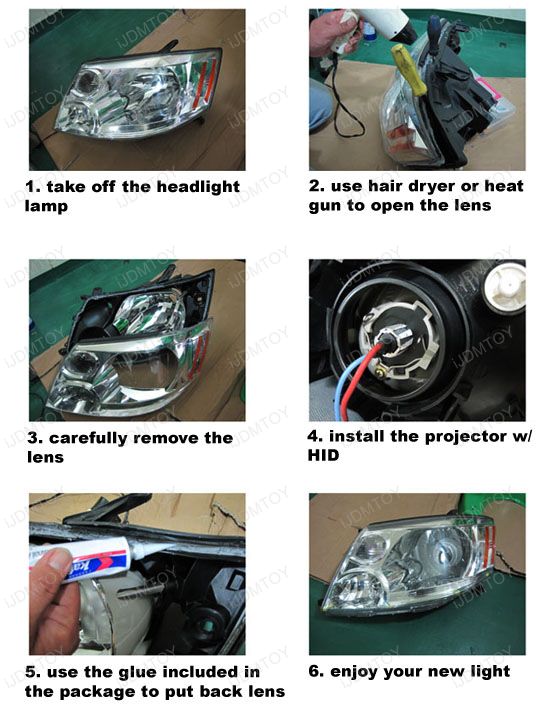

A couple of members on here have taken them apart by either heating them in the oven, or using a heat gun. I would personally feel more comfortable with using a heat gun over the oven method, but maybe I am just chicken.
I have thought about taking mine apart to install these. http://store.ijdmtoy.com/Projector-B...ctor_sku80.htm

I have thought about taking mine apart to install these. Angel Eye Headlights | Projector Headlights | Bi-xenon HID Headlights
Using a heat gun would be nigh on impossible as one area would be getting cold as you worked on it.
The oven method does not appear to work from what I have read.
One member opened them up using an Xacto knife between the front and rear parts. Others have sawed them apart, If I had to do it I would favor the Xacto method.

Ever heard of using wedges as you heat each section.

No I have not. I have not read about it on this forum anywhere but maybe I missed it.
Have you done this? Please enlighten us with your expertise. I heard that the cement used on these lights does not lend itself to the heat method.
