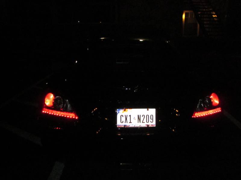

This is my first installation of LEDs under the lower edge of the tailights - I'm going to change them out with a different kind of LED because these didn't line up as straight as I would like. I am also going to have a strip along the outer edge that will flash and then stay on when I apply the brakes --- call me crazy, but I like lights

LED'S look good, that gives me an idea of houw its going to look when im done.
