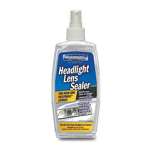

Default Re: What to do AFTER Headlight restoration to keep it fresh?
Blue Magic Headlight Lens Sealer, Prevents Yellowing
Blue Magic Headlight Lens Restorer, Removes Yellowing
Going this route myself.. applied the sealer yesterday.. really made the headlight plastic "pop".. we'll see how long it last. Was using the cleaner about once a month..

That was the first product I bought - did no good at all ( mine were pretty well GONE when I bought the car ).
I tried a couple of others, finally ended up with the Meguiers Heavy Duty kit, that WORKED !

I actually wet sanded mine before I found this forum and all the information. They were a nice shade of yellow with a few "hard lines" in them. Looked decent for a couple of weeks.. then the yellow was starting back and that's when I picked up the polish restore..been using it about once a month to freshen them up.. now I'll see how well the sealer does. Like I said.. they looked pretty sweet after applying..
