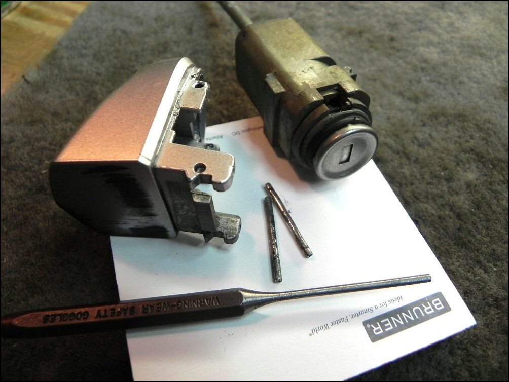

Does anyone have any experience dealing with the outside driver door handle/lock?
Can just the lock cylinder be exchanged into another handle without affecting the handle parts? I see variations for sale on eBay without the lock, but part of the handle is missing as well.
Can you remove the lock cylinder from item #1?

So here is what I learned today after the mailman delivered.
The lock cylinder can be removed from the handle assembly using a drift punch to remove two pins. See pics.
If you need a new door handle, the cylinder can be switched out so your same key will work.
The right and left pull handles are the same.
