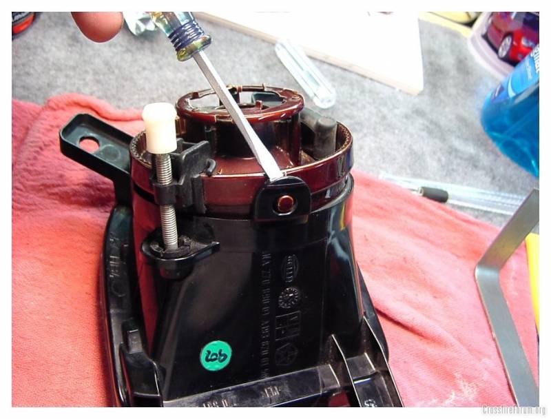

There is one adjustment, vertical. It has to be made after installation. There is an adjustment **** to use on the back side of the light assy. You can gain access to it through the door on the inner fender panel. Use a closed garage door to get them egual and a height you like.
Look for the white **** in the pic. If I remember correctly, you will need a torx bit to make the adjustment.
Look for the white **** in the pic. If I remember correctly, you will need a torx bit to make the adjustment.James
It is actually a 6mm hex Allen key. I just measured one.
