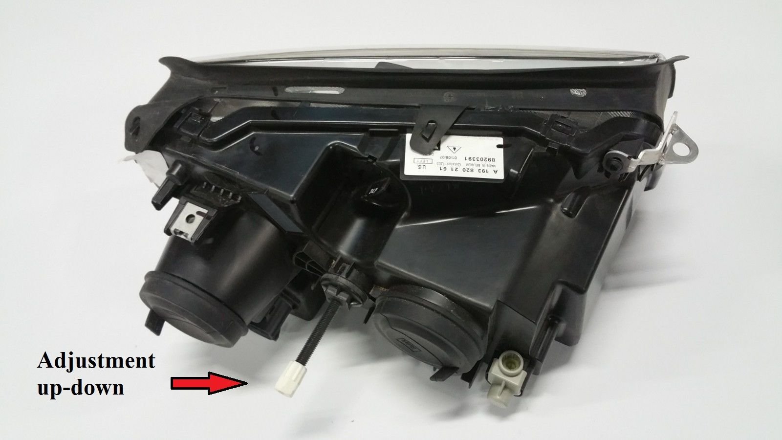

First Be sure the light bulb is in the socket correctly as in the picture in the post above by Mrmiata. Ninety percent of the time that will cure the problem. If you must adjust vertical beam of your headlights it is done by turning the **** located in the center of the light housing (between the two bulbs), turning counter clockwise will raise the beams. Adjustment horizontally is done by turning the **** located on the high beam side of the housing(closer to the vehicles center). Turning that **** counter clockwise will move the beam towards the right. Keep the beams pointed down and to the right. DO NOT point the beams straight ahead or too high as you will blind oncoming cars. The ***** may be covered with a cap which you will have to remove. Use an allen wrench to reach into the plastic tips of the ***** to turn them.

Zip439, thanks again for this information.
Is it possible that you might be able to take a photo and detail which dia/**** I should be turning to raise the low-beam's height?

If the adjuster was turned too far up and the threads popped the adjuster out of the socket. Simply turn clockwise slowly until you feel a pop now the adjuster is back in socket. If bulbs are seated properly turn counter clockwise until aimed properly.

The adjusting **** raises the high and low beams together. Get the bulbs located correctly before using the adjustment ****.
There is not much point in having the low beam correct with the high beam aimed at the stars.

Hay there Greg, Good picture thanks!
The subject comes up so many times... and a picture is worth 1,000 words..
