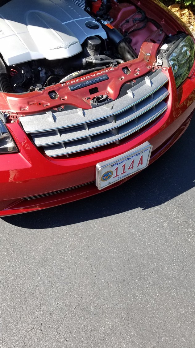

My Grille, Done by DTMenace:

If you send me your email address I can send you pictures that you should be able to blow up and take a close look. By the way, those marks on the facia are reflections, not damage. One other thing, in case you are wondering, the lower grilles are billit aluminum, which I did not remove.
Bill T.

Bill - The pictures you posted came thru fine. Looks very nice! Thank you for responding.
Jim
