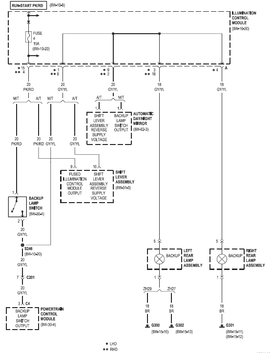

My backup lights don't work. All other lights do. Any thoughts? Is there a switch in the shifter that could be bad?
Old Jun 20, 2019 | 05:55 PM
Default Re: Backup lights
Either fuse 4, backup switch if manual, or shifter assy if automatic :
Old Jun 20, 2019 | 06:05 PM
Posts: 6,641
Likes: 776
I checked the bulbs, they are fine.

Well, the directionals were a loose plug to the headlight switch (ECM). Now if I can figure out how to trouble shoot the backup lights? I do have a bulb out warning light when I turn on the headlights.
