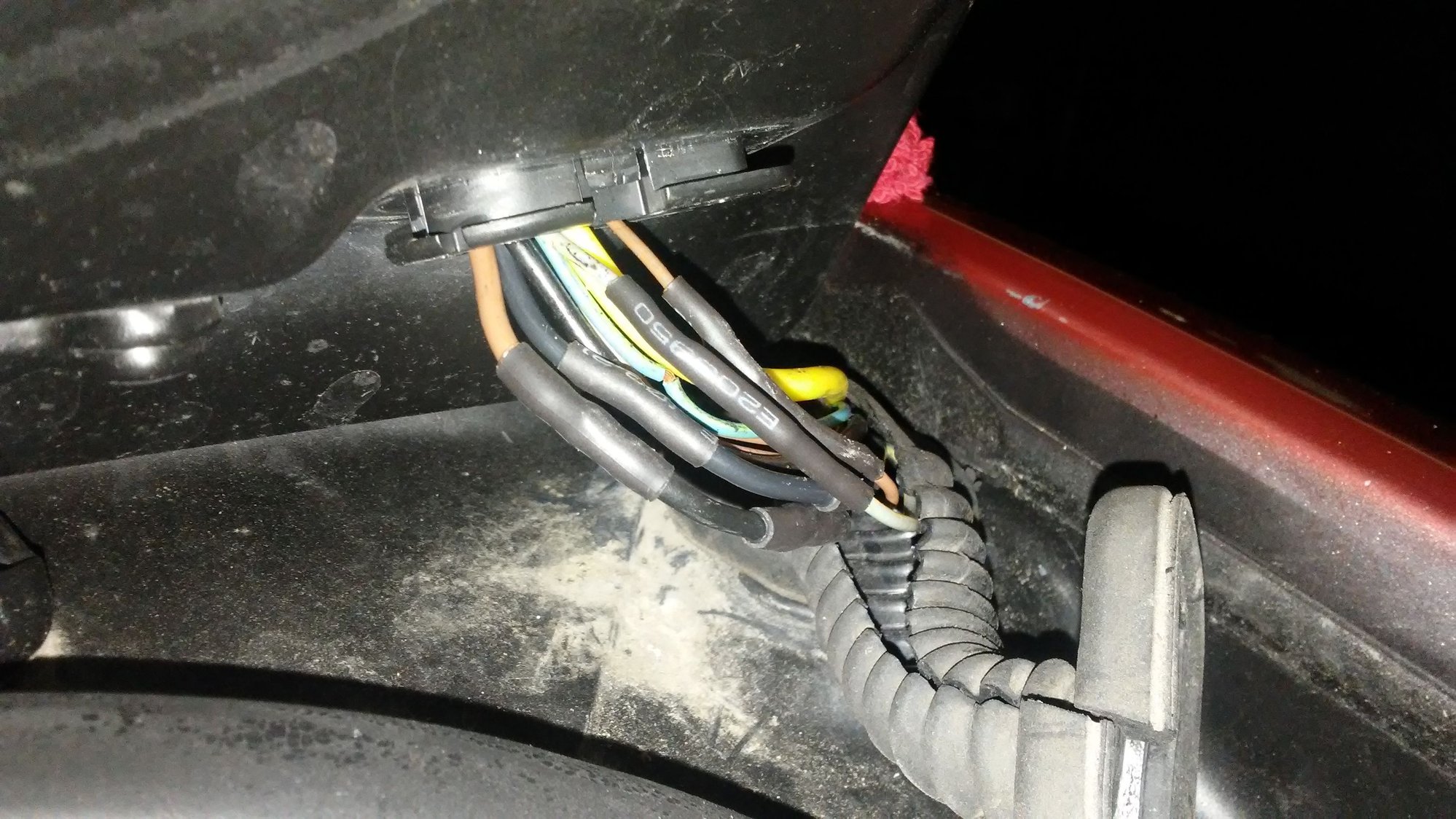

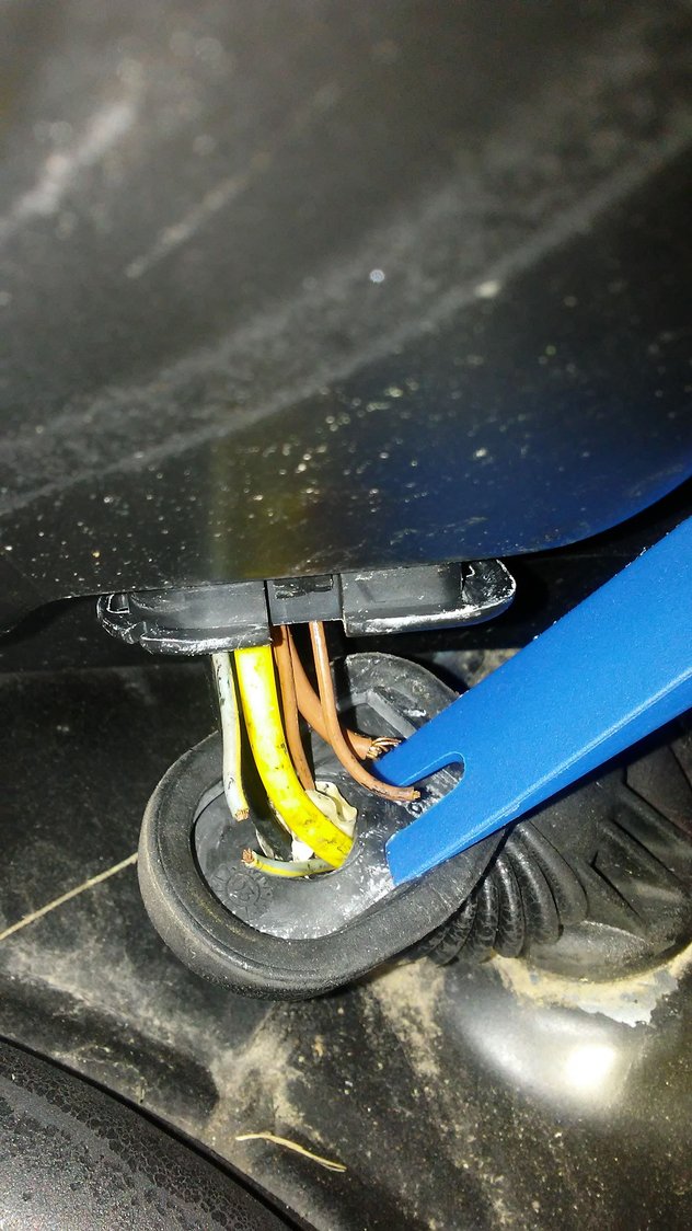

I'm very surprised this isn't a very common issue. 4 broken wires in the passenger side grommet. Likely my rear defrost wasn't working, but will now. Used a wire tracer tool, but wasn't really necessary. My dad was in town and he wrote the electrical connector sticky on neons.org in 2007. Added an inch of wire to each, lots of soldering, marine heat shrink, a final wrapping of electrical tape and sealed with black rtv. It was a struggle to get the bottom part of the grommet back on, the secret is to remove the one black retainer from the headliner itself and you can get your hand in there and push up on the plastic piece, to put the lip of the grommet back on.

This is Tad's dad. Couple additions to add. The rubber convoluted section had to be cut to get access to do soldering and heat shrink. To get heat shrink far away enough to not get it to shrink in the wrong place from the heat needed to solder, you need a few inches of wire to slide the heat shrink away. The black defrost wire was broken very close to the bottom grommet. We probably didn't need to undo the bottom grommet, but didn't know it wouldn't help and we thought we could just slide everything up. That bottom grommet was almost impossible to get back on and we struggled with it longer than it took to do the soldering. The original wires may have been too short and stressed from opening and closing the trunk many times. We added an inch to each broken wire. We used 3M 33+ tape to wrap the wire bundle so it flexes as a single unit. The top grommet had to be zip tied because we cut it. The cut along the convoluted part was filled with ultra black rtv and we're letting it set 24 hours.
Any electrical malfunction in the trunk is most likely due to broken wires in the convoluted section. When you can't figure out why the lighting, defrost, or the spoiler won't work, this is where to look.

The black wire for rear defrost especially did seem quite short, however you have to cut the rubber grommet to get in there and do soldering. I am leaving my driver side grommet alone, presumably the wires aren't so short on that side? I would leave it alone until you get an issue with rear defrost or license plate lamp. The other two broken wires were brown ground wires.

You should do the heat shrink joints away from the flex point, the flex will now be concentrated at the end of the heat shrinks.
Lengthen the wires and keep the joints in an accessible spot, this may be under the roof liner.
You probably can do this without cutting the rubber boot, replace the roof fabric at the same time if needed.
