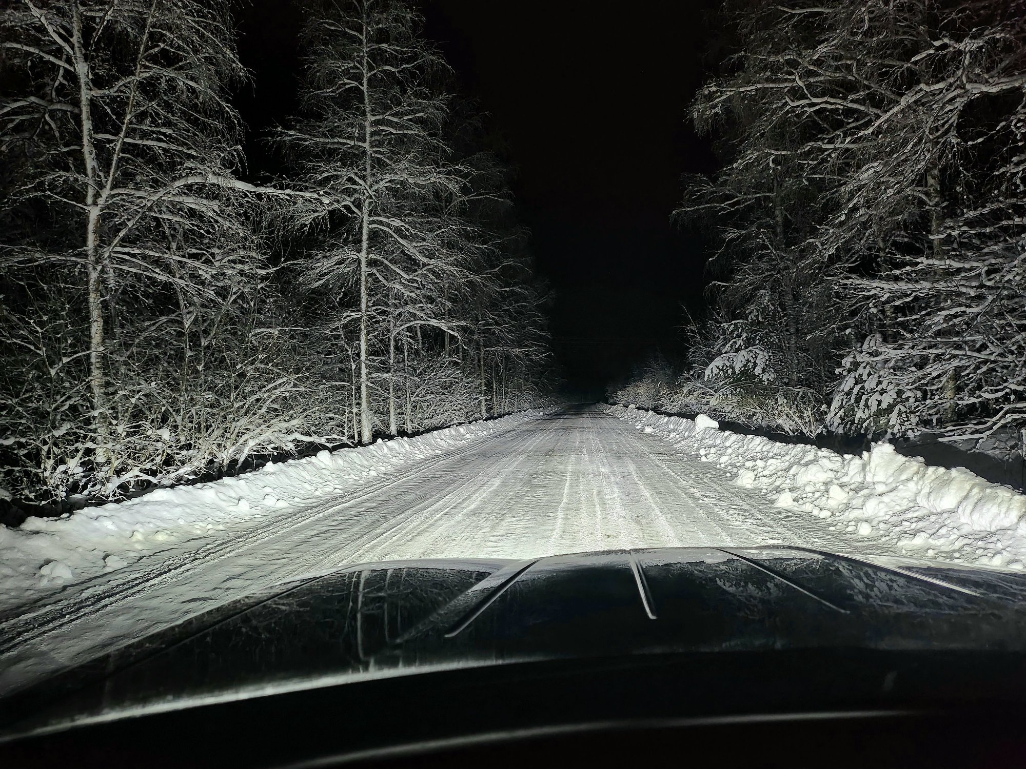

Only fog lights on
Fog and driving lights on (no high beams)

Now I have an idea of the much better visual distance. Looks like I'll be adding these to the "To Do" list. Thanks for the pics.

Originally Posted by jtammel
Only fog lights on
Very nice but what is the part numbers you used, there are six low beams for instance?

I have these currently:
Low beams: Novsight 120w H7 LED 6500K
Fog lights: Novsight 120w HB4 9600 LED 6500K
Here in Finland those kits go around 140$ per kit
