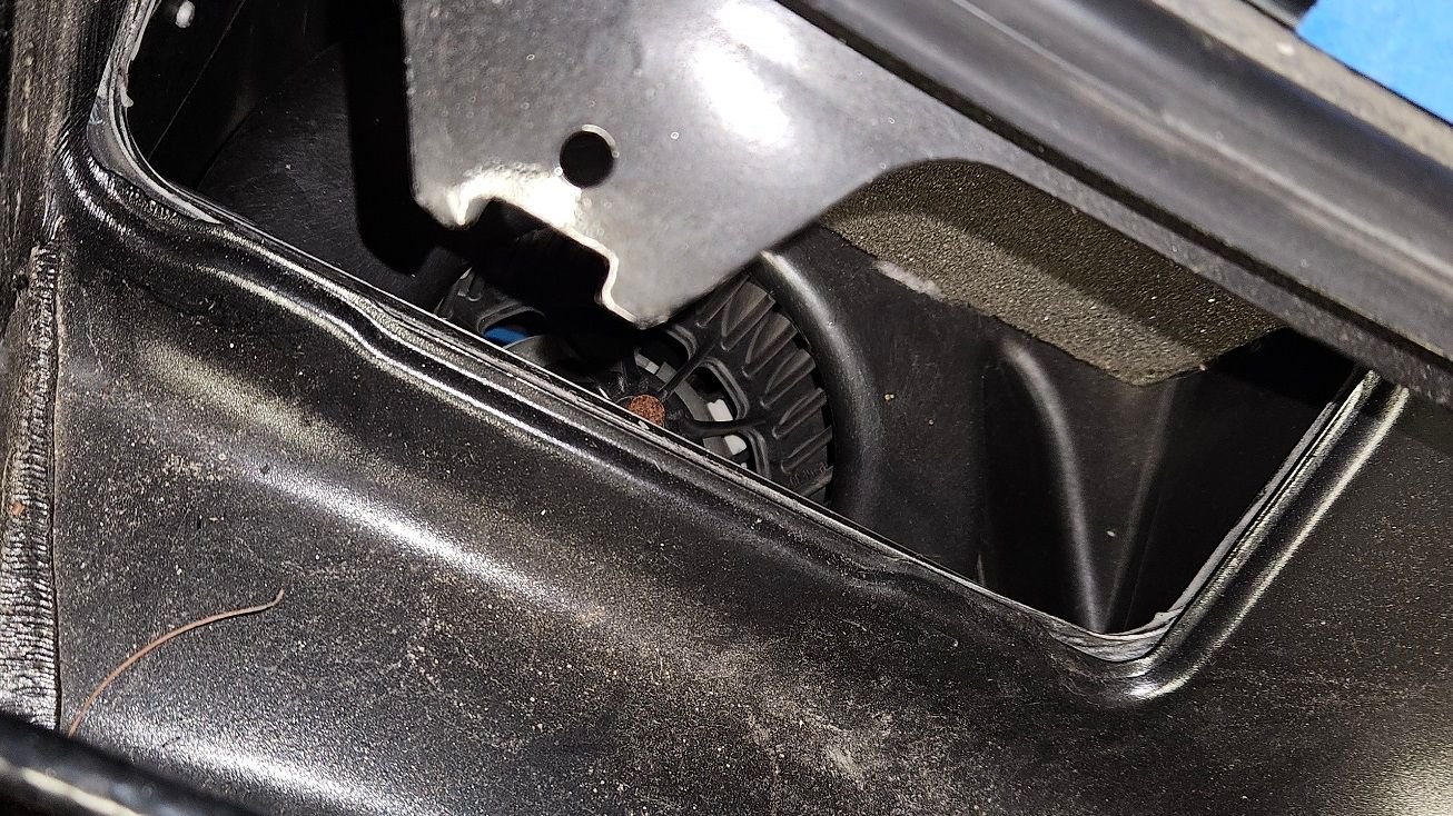

Do you happen to have a picture of your flapper door? I'm just curious about the backing material.
It's not a big deal if you don't. Thanks.

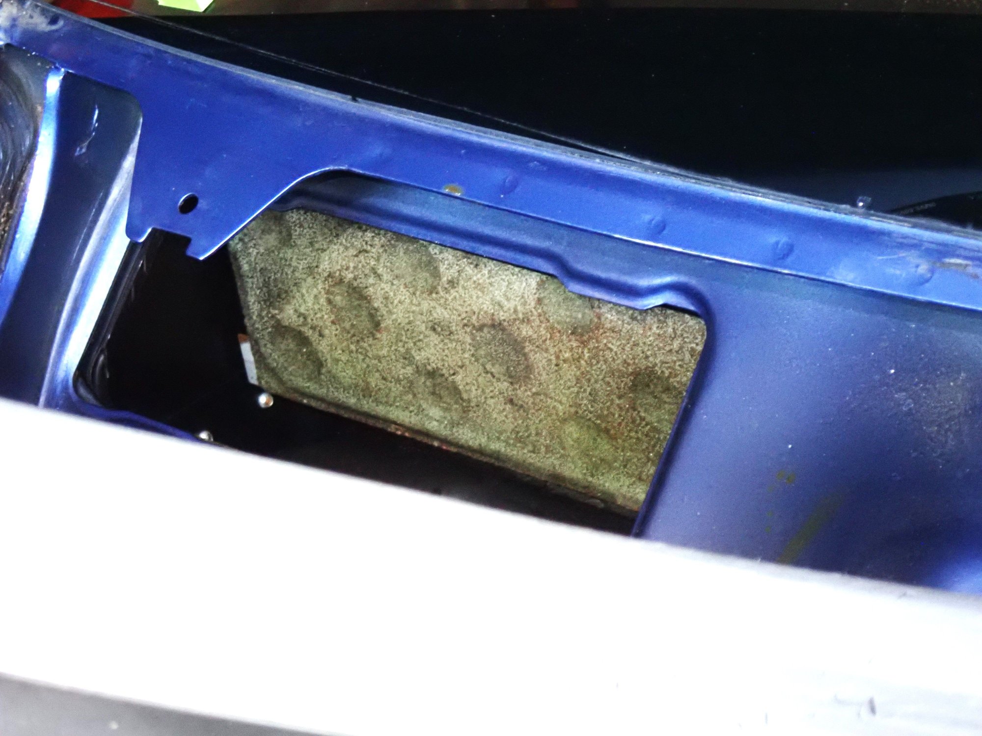

Photos of the flapper door as requested. Texture is probably adhesive which held foam on backing (enhanced by 18 years of dirty air). Circles indicate holes in the metal or plastic door.
My first attempt at loading photos on this forum, so may be way too large. If so, will try again later.

Flapper door controlling input to heating/ac, located under cowl cover. Age has taken foam surface leaving only backing layer on metal or plastic door.
Third try? Think I may have it, limit photo to 800x600 pixels or less?

Thanks for the pictures! I appreciate it.
I actually found a pic of mine buried on my phone. I forgot that I took it for a post on FB.
The thing about posting pics on here is mainly no more than 10 per post and try to keep them a reasonable size. Also, if you quote someone who has pics in their post, delete the pics to save web space. I just found this out myself! LOL
Here's mine. Apparently I still have the foam but it looks like it's starting to go.

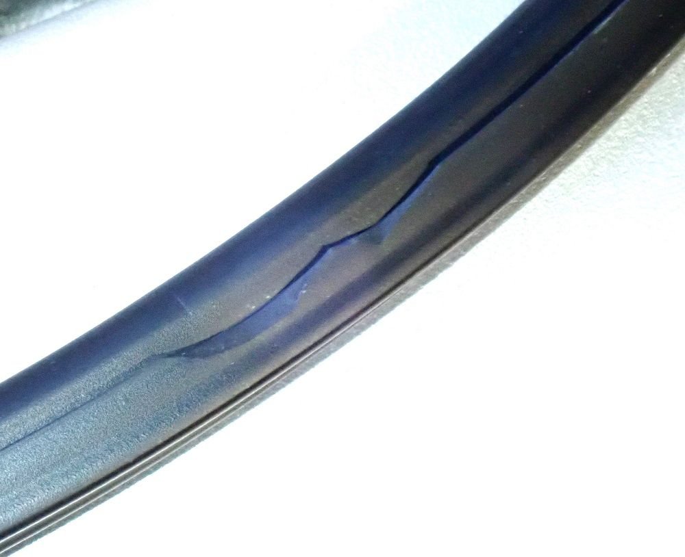

Possible "WHOA!" moment, guys.
Attached 3 photos show:
1. The glass/cowl gasket installed on the glass with shorter leg on top side (labeled with "A" on tape).
2. The glass/cowl gasket installed on the glass with longer/rounded/thicker leg on top side (labeled "B" on tape).
3. Short section of gasket where the longer/rounded/thicker/leg was damaged, probably during my removal.
Before I removed the gasket, it was in the "A" position, which may have contributed to the longer leg getting caught in some of the sealant.
Research on possible replacement gaskets seems to indicate they are installed in the "B" position, which would appear to create a better seal.
Would appreciate feedback on whether A or B is correct, or did some tech in the mists of time just use what was on hand in his shop?
If I replace this in the B position, will the slight damage shown in photo 3 be of significant concern?

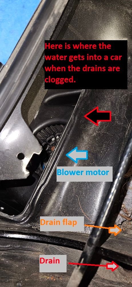

The correct position should be "B". Look at my pics and see if you agree. This was the first time my cowl was removed.
By the way, I painted the cowl and Used McGuire's Ultra Black on all of the rubber and plastic pieces before I reassembled everything.

is there any type of Barrier or Dam to keep water from rolling down windshield and into fan & cabin filter area. Yes all drain holes are cleaned out regularly Thanks in advance
Rich B
Old Jan 31, 2025 | 11:59 AM
Posts: 3,189
Likes: 1,726
Default Re: Questions under the cowl cover--gasket and flapper door.
Rich B
When the cowl is in place, it should route the water away from the blower motor opening.
