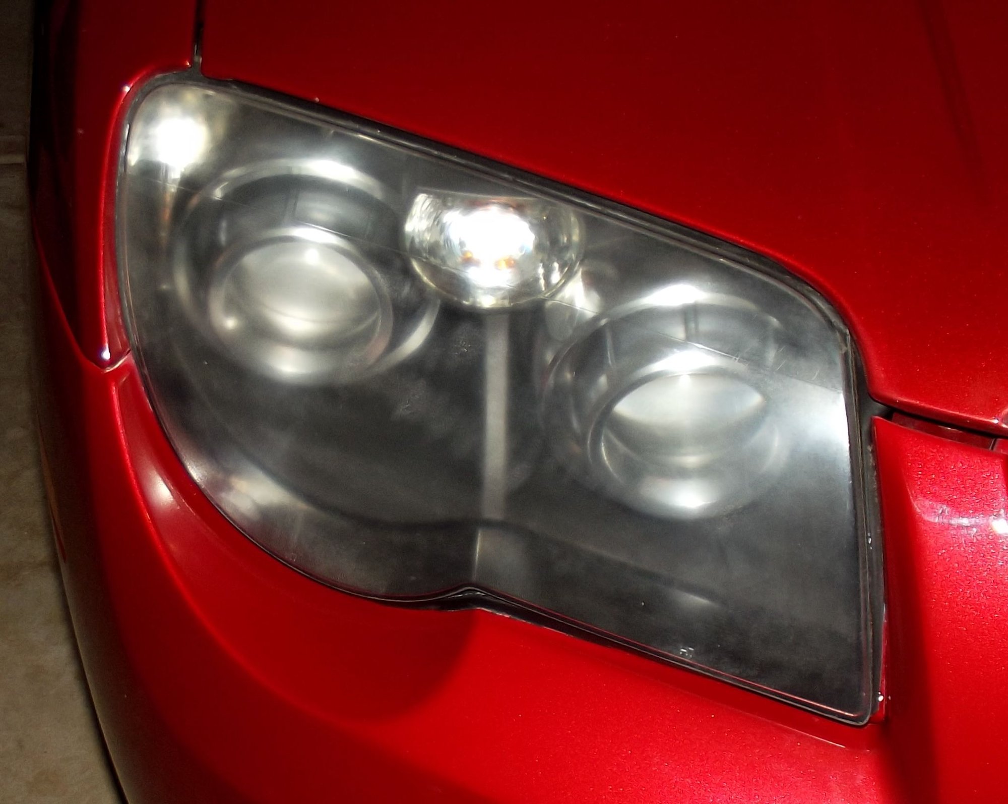

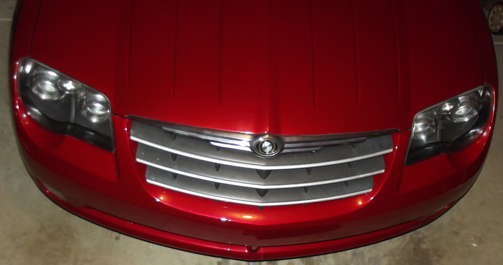

Hi guys,
A detail shop buffed out my cars headlight lenses. I thought they did a crappy job so I used baking soda and toothpaste on them. No change. The lenses are nice and smooth but still clouded and marked up in certain areas. It looks like it's on the inside though to me.

Default Re: Cleaning Head Lamps
I thought about that but like I said, it all looks like it's on the inside. I didn't want to waist the time and money. If you look at the picture of the drivers side light look at the bottom in front of the low beam lamp. I circled an area where there are particles of something laying there. It looks like plastic particles. Now, look at the other area to the left. It looks like the plastic has deteriorated and some of it has come off. There's another larger area but you can't see it in this picture. It almost looks like the plastic has crystalized somehow.

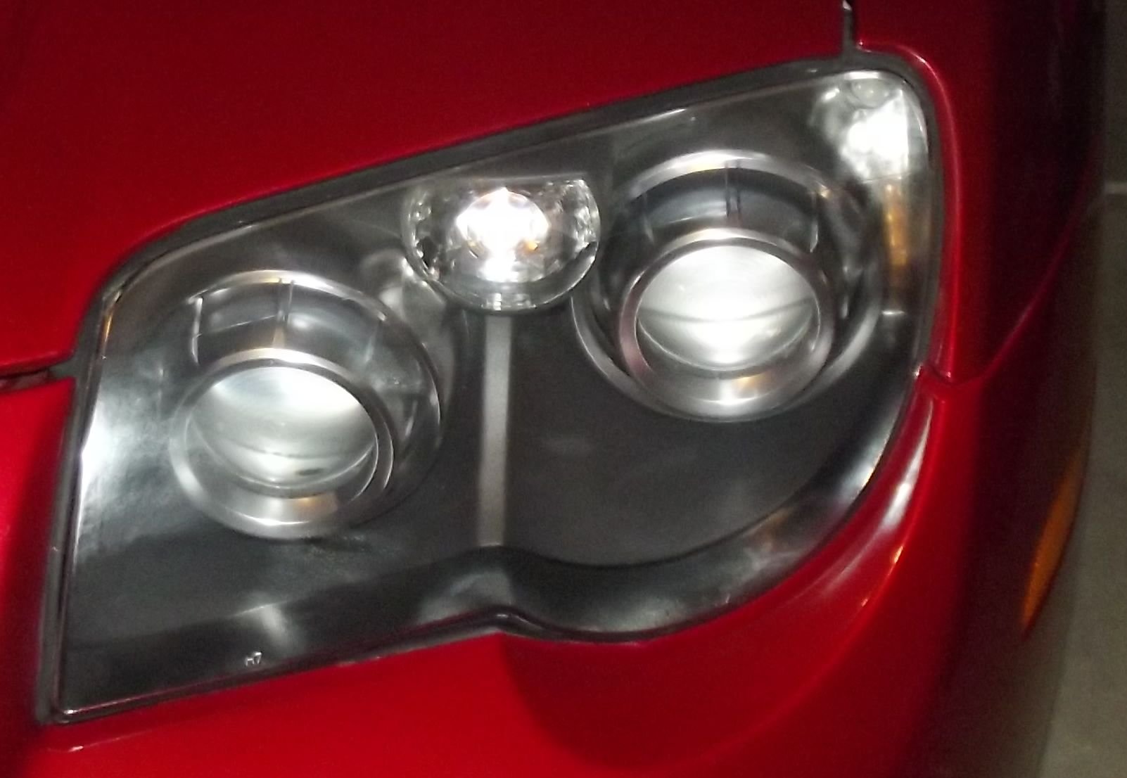

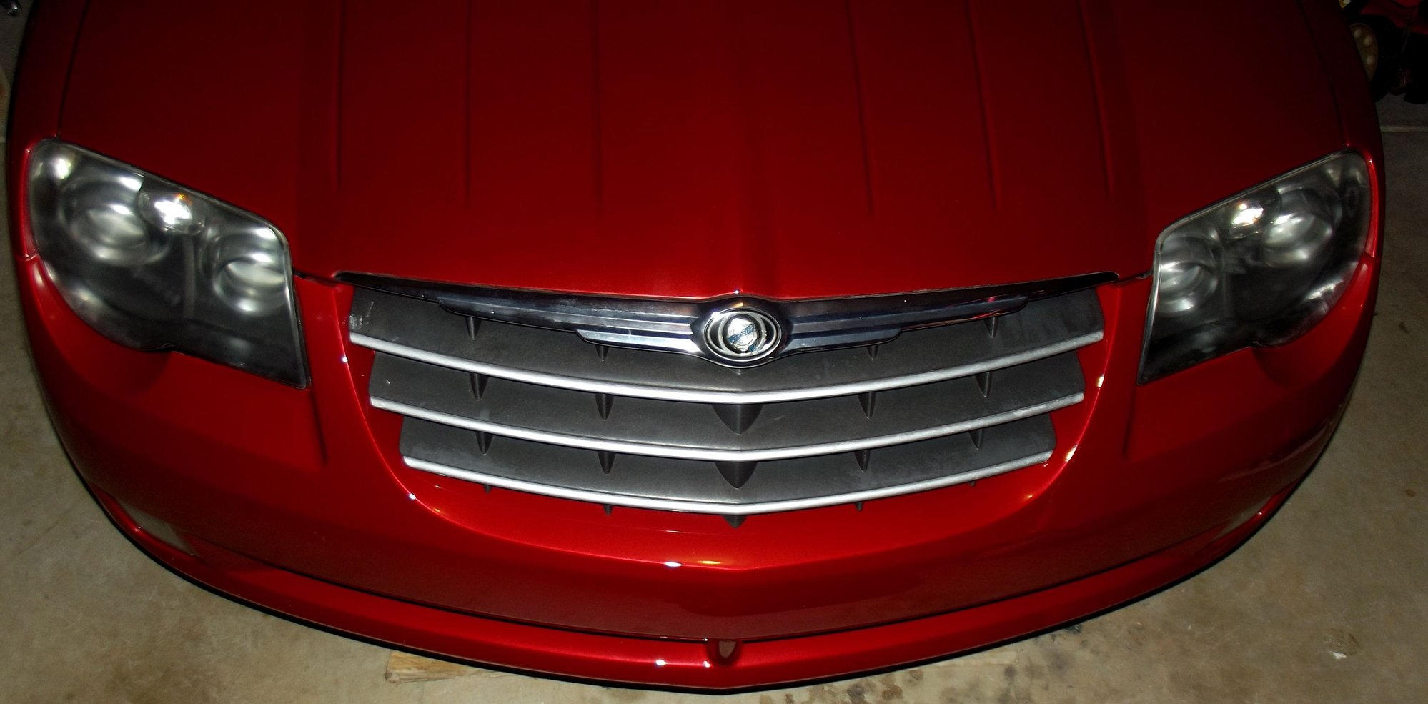

I bought a kit for headlight cleaning and did that today. Here are the results.
Mikey 208, It looks like you have made an improvement in the clarity of your lenses. The 2 spots you circled were more than likely created by dwelling a rotary abrasive pad too long in one spot causing localized heat to be generated. As a result the plastic has melted in these areas. The only way to remove this condition is to once again apply the sequence of abrasive buffing to this area. It will take some work but you should be able to bring it back to look like the remainder of the lens. You could start out by using a more coarse grit abrasive in these 2 spots. This will initially remove more material, then you will need to gradually apply increasingly finer grit abrasives to bring back the clarity.
