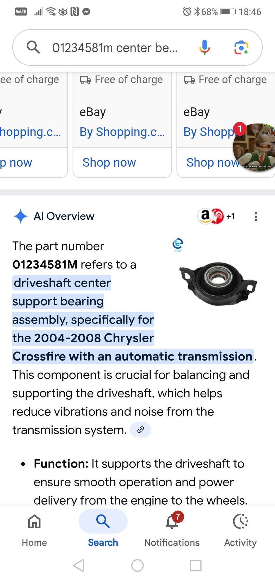

So I had read the same a while ago, more about the year it was released than country.. I own a 2003 crossfire, according to the "Internet" and all part suppliers, my car doesn't exist because they were manufactured in 2003 and released for sale 2004...mine clearly did a runner Nov 2003
So I'm in desperate need of a center bearing and support, parts place sent garage wrong part so I've been tasked to find one, everything online says 2004 to 2008 but I'm assuming from everything I read on here that it will be the same part 01234581M if anyone could confirm you'd be doing me a favour, I just can't afford the time or money getting more wrong parts.. MOT looming lol

Thanks, the garage is doing my repair, he's already done the rest of the work, checked everything else but was sent the wrong part 🫣 when I search only one comes up that will fit the automatic and says all crossfire 04 to 08, doesn't seem to be any other option so I hope it's the right one 🤞🙄

Here is the correct part. I used this when I replaced mine. I have a manual transmission in my Crossfire: https://needswings.com/driveshaft-support-and-bearing
I hope your mechanic is also replacing both of the rubber flex discs as well.
Here's a post I did when I replaced my driveshaft bearing and flex discs:Driveshaft support bearing & flex discs replacement
Fantastic, thanks for that, looks exactly what I've ordered but mines automatic, it does say mines for auto though so 🤞 I'm gonna get the flex discs too, thank you..
